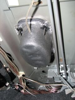

    +1 for the factory sub box. While they are rare, if you can find a factory XR7 box, you can replace the factory 6.5" driver or even retrofit an 8" into it. It mounts under the decklid and doesn't sacrifice a ton of trunk space - way less than most sub boxes - and can fill the spectrum enough to give the door speakers a break. :)
    https://forum.birdcats.com/threads/factory-jbl-sub-rebuild.177/ documents my journey.

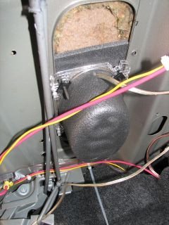

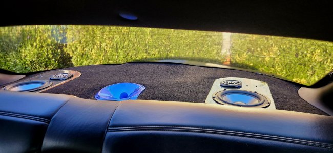

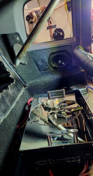

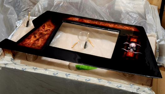

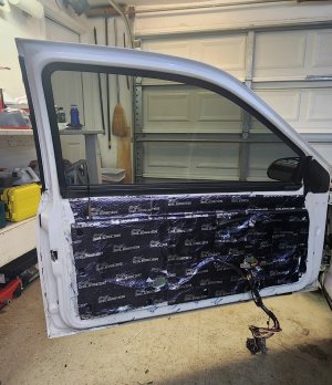

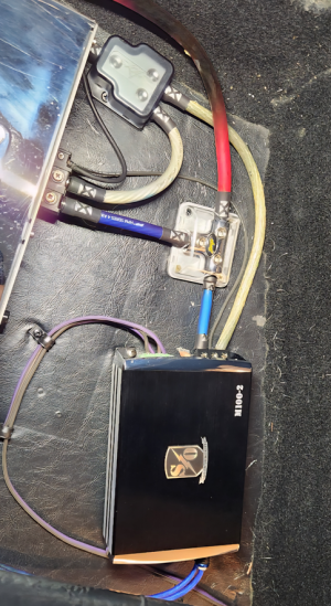

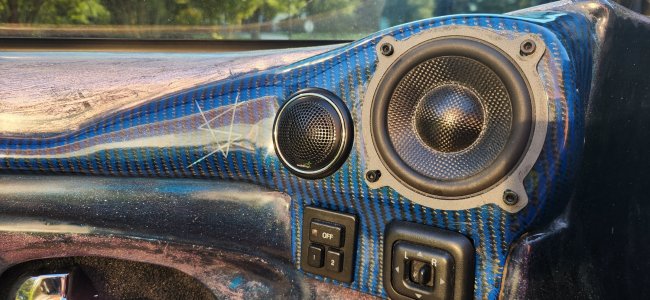

    I did a set of free air subs in the rear deck of my Turbo coupe. System sounded great and was well balanced enough that the lead guitarist of Anthrax would listen to their tracks they were working on in it. I'm finishing up the revamp of the system in the Cougar right now and also gearing up to do the one in the Focus. Cougie got a set of Rockford Fosgate Power T1682's for the rear sides and an impressive little Sound Ordinance M100-2 amp to drive them. I was getting everything removed in the non-back set area so the tint guy could replace the old peeling tint. Not an easy job with the cage but they managed to get it done properly and it looks great. I also removed the custom door panels to make things easier for them and went to town on adding the layers of sound deadening I failed to do before on the doors. I also sound deadened the crap out of the rear side inner and outer panels and stuffed moving blankets in the open spaces.
    Finishing up a deep pour on the amp cover thing.
    -Scott

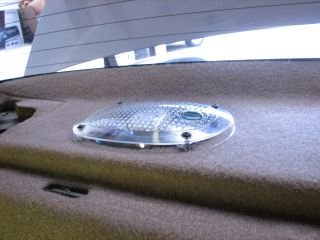

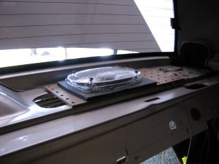

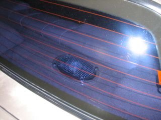

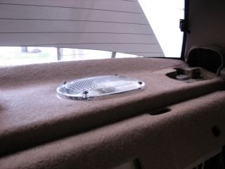

    I already have 4x6 2-ways in the deck.
    Did you install them? If you can post a picture I would be interested in seeing that. Do you think 6x9s would fit there? Even though they aren't that much different in size, 6x9s seem to make way more bass and have a better selection.

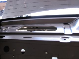

    I do not believe I ended up using the pegboard mounting plate. I used the 4x6 because it fit best of the speakers I was looking at. One down fall to the 4x6's I used, they don't put out a log of sound, as you mentioned AND they are 2-way coaxial.
    I installed a set of passive radiators in the rear deck of Linky to help the subs pass gas... and a cone. The tweeter horns were never hooked up.
    Audio Frogs for the win.
    Somebody is serious about their car stereo enjoyment... :P
    Thanks Scott, I now have a complex about the "size" of my stereo system....
    I have some of that blue/black kevlar/cf material, also some red/bk I was going to do a hood with, but a me convinced me it wouldn't stick to steel in the sun.
