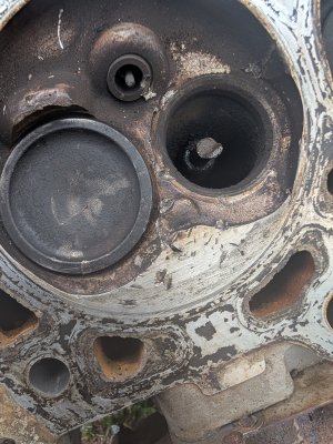

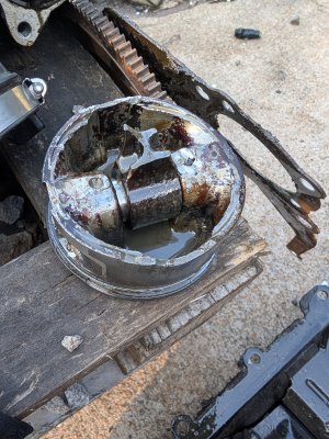

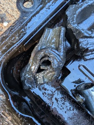

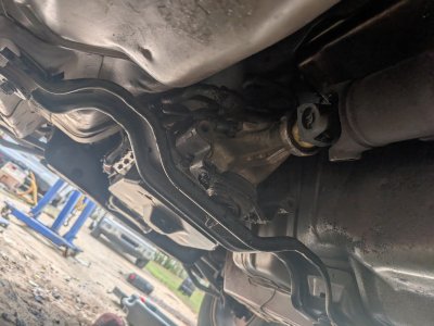

Been a rough end of last year had a kid so that took a lot of my time. Things are finally settling down and I can start fixing the bird again. In the course of that time the transmission finally gave up the ghost, was a matter of when not if, also didn't help it out by any means. Anyways been on the search for a transmission for a few months and finally found one. Grabbed a 2002 grand Marquis with the 4.6 and a 4r70w for 800. Car honestly just needs a fuel pump but I need the parts. Figure total in I got an engine and transmission for around 500 after scrapping the shell.
Picking that up tomorrow and will start the tear down.
Based on what I have researched looks like I have a PI head and intake swap. Also looks like I solved my violin case issue. Been quite but still here grinding away.
Rebuilding that 02 trans by this guide:
This will give you the best trans you can get. But, you have to keep the 94 solenoids. 94-95 are different impedance than the later ones. Raybestos blue plates in the direct, kolene steels, one piece teflon shaft seals. It'll last forever.
