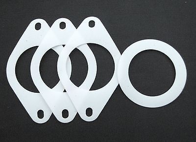

As far as I know, Dan stopped making them, but it looks like someone else started. If Dan is making them again, get them from him. His were better made than the ones that are now on eBay, but I’m pretty sure he decided years ago that it wasn’t worth it anymore for the few sets he sold. The eBay ones work fine, but aren’t cut as nicely or accurately as Dan’s were, so you might need to spend a little time trimming them to get it to fit just right.
Not my gaskets; I sold all my inventory to the point where i dont even have a spare set for myself. The seller on Ebay is Speedwagen from SCCOA - he copied my older designs back in 2006 and my old spec with the thinner .06" material. They will work just fine, or as an alternate .. RTV works just as good.
FWIW - those $33 gaskets used to cost $15 - I priced mine at $22.50 w/ free shipping because the .125" Teflon was 4x the cost of the. 06" .. I sold those ones for $12 a set originally.
Bill from SCP wanted to buy my templates or make me an exclusive provider years ago - I couldn't imagine how much he'd mark them up and I declined the propositon.
