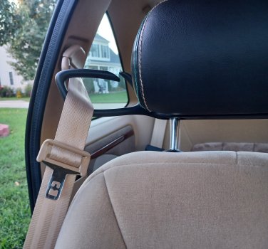

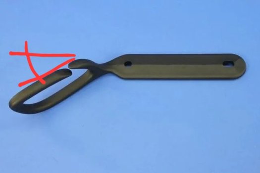

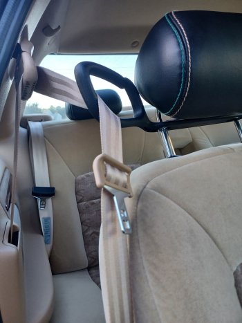

The Challenger ones' holes are almost the perfect distance. Just sand out about an 8th of an inch. Most importantly, the Challenger ones are the only guides available with a distinct forward angle; all others point straight sideways. That angle fits the general belt geometry much better:
Why do this in the first place? Well, it makes it easier to grab the seat belt from behind you. But really my main reason is that I like the vibe they give off: sort of a typically American two-door feature.
I fed a black rubber hair band through the holes which eliminates any risk of rattles, and a translucent tube prevents them from sliding down.
