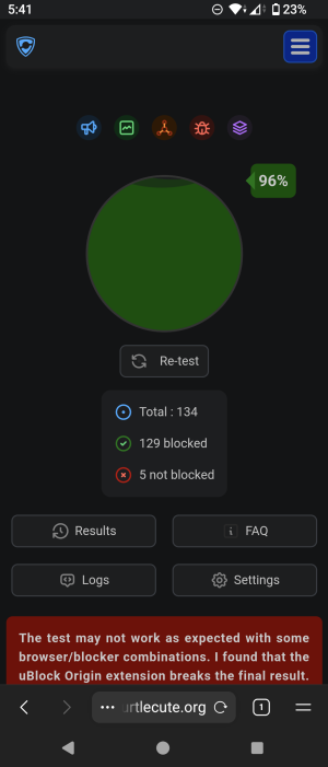

Ad block test:
https://adblock.turtlecute.org/
Use this test after you have everything configured. Firefox/uBO has documented incompatibilities with this site, but this is my result in Whale, which is a Chromium-based browser with some basic internal ad block filtering, plus DNS-level filtering with NextDNS.
