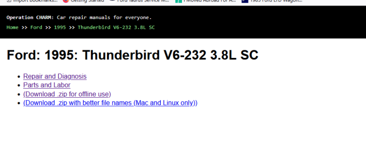

Take a look at this web site if you get some time:
You can go to the Thunderbird (Cougar) for diagnostic info. You can download it as a file as well.
Stupid question, but how do you download them as files? I can't see any option for that, the best is right-clicking and saving the link.
I was able to drill down to a link to download a zip file.
There is a lot of easy to access information in here!
...but the zip file isn't overly helpful. You get a bunch of pages with links, to procedures, but none of the links work. Not sure what I'm doing wrong here. For a 42MB download I would think it would all be collected together.
Jeez, am I retarded? I was looking right at those two links (in the V8 version) and didn't even read them, hahaahahaa.
Well, I downloaded the ".zip with better file names" and, how about that, it worked! You have to read the README.txt file, it says to click on the index.html file and when I did that it opened a tab in my browser, looks exactly like the website's version. The links that I tried worked, pictures and all (man, that's a lot of sub-directories). You might have to try the other .zip file since Windows hates long file names.
Got it. Thanks for the infromation. I suppose it can be helpful to read the instructions from time to time although I normally find them a senseless nuisance. Got the factory manual for my '85 wagon downloaded even though I have all of the books. Nice to look things up quickly.

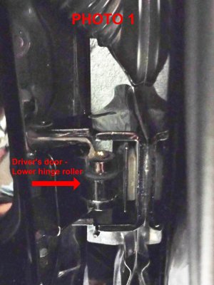

Every 6 months for several years, I use silicone spray lube to lubricate the car's hood & trunk hinges, door hinges, door/trunk locks, latches, and other friction points. Afterwards, the driver's door hinges will make a snapping or popping sound for a couple weeks, when opening or closing the door, then get quiet again until the next lubrication time. The doors operate normally and smoothly & quietly with no impingement, sagging, or other issues.
Does anyone know why they make that snapping & popping noise after the hinges are lubed?

Yep. the hinge on the driver's door on the '97 does the same thing when I lube it with white lithium. I found the answer a while back, but I forgot what it was or where I found it. Here is something I found on some site that was part of a club of Thunderbird and Cougars that was based in America. Mind you, I haven't looked at my car yet.
The lower hinge has a plastic roller that is designed to hold the door in position when open. The hinge has a spring loaded follower that rides on that roller. After a while the plastic roller starts to wear a groove and the follower will make a popping sound when it hits that groove. The spring isn't a coils spring like you'd think. It is nothing more than a piece of bent metal that holds the follower against the roller.
A temporary solution is to open the door about halfway and observe the roller in action. There is a point in the swing of the door where the follower doesn't contact the roller. Find that point and reach in there with a screwdriver and spin the roller around 180 degrees. Chances are the roller will still be painted body color on that side. Bada-Bing you should have a smooth pop-free hinge.

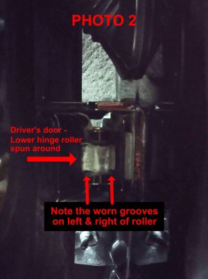

After examining & playing with my door hinge and doing what's described in your posting, the popping noise has been eliminated when the door is swung to open or close it.
(Photos attached, so future readers with same question will better understand)
Photo 1:
The body-colored lower hinge roller that your posting described.
Photo 2:
The same roller, but rotated around. It's free-wheeling and can be rotated with fingers.
Now we can see the two grooves that are the cause of the popping noise.
Why two grooves, I have no idea.
Solution - To eliminate the popping noise:
With a finger, rotate the roller into different positions and then test door for popping noise by swinging it open & closed.
Different positions of the grooves will result in the popping occurring at different times during door opening & closing...but with the right position, the popping should stop or be strongly muted.
In my case, leaving the grooves visible to the eye, like in Photo 2, eliminated the popping.
I don't know if the roller will rotate again on its own...but in all the years I've owned The Car and cleaned & lubed the hinges, I never saw the grooves because all I ever saw was the body-colored un-grooved roller, like in Photo 1, when looking at the hinge on both doors.
Although we have our solution to the popping noise, I'm still curious as to why lubing the hinge causes the popping noise for a couple weeks, then it vanishes. Unfortunately, given the tight & obstructed confines of the hinge, there's no way to get a close look at what's happening in there to better understand the issue.

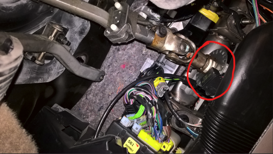

While dealing with the popping hinge issue I posted earlier, I took this driver's side under-dash photo.
Circled in red, what is the metal-perforated disc and the black unit wrapped around the edge of it...and what do they do?
Thank you
Vehicle: 1997 Thunderbird Sport
Thank you

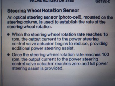

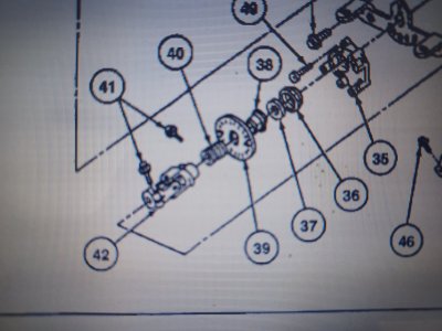

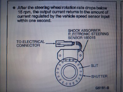

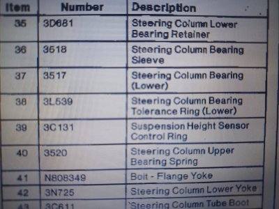

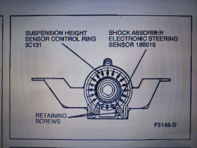

The manual calls it "Suspension Height Sensor Control Ring".
It's a rate of turning sensor for the evo system. If you jerk the wheel headed into a different lane, you get full assist from power steering.
Here are snapshots from the manual which explain operation.

Thank you for your time to find and post these page images to explain it.
I have the factory service manuals, but didn't see this...I missed it somehow and will look again.
I thought you were joking earlier when you said it was the "Suspension Height Sensor Control Ring", because that name doesn't make any sense, considering its steering-related function...but it is what it is, I guess.
These steering columns are used in countless Ford models of that period. I imagine that when they first designed the column (and gaves names to its pieces), that ring was indeed used to control the load-leveling suspension, e.g., of a Town Car, possibly to inhibit height adjustments while cornering (?).
On SCs it’s controlled with the ARC module, could be integrated with the air suspension on Mark VIIIs

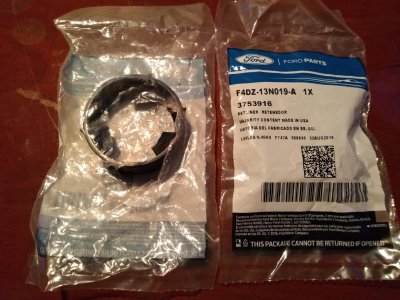

Where the bulb mounts into the headlight housing, there's a black plastic ring that locks it into housing. You rotate it to lock/unlock the bulb from the housing. See the attached photo. If you use a flashlight to see where the bulb inserts into the housing, you'll see the black retaining ring and the wiring harness to the bulb inserted through it.
Note: There's 3 tabs inside the ring...when the rings are old & brittle, the tabs break off easily. That's why you should get a couple new ones, unless yours are in good condition.
