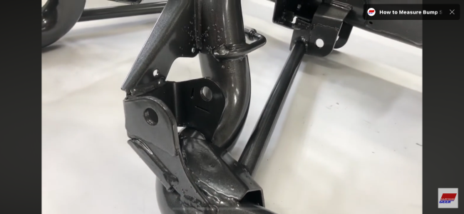

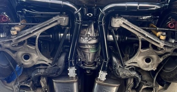

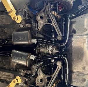

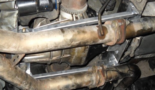

Here we go again, this time with 50% more proof! 😬 so a lil while back I posted a picture of some bracing Dale Brown on the FB group had made for the IRS, basically connecting the front control arm points to the rear. I’ve added picture for reference.

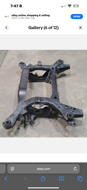

After snooping around I found something VERY similar to this brace in the factory IRS from the terminator cobra, basically tying the control arms points together, you can see the bars in the 2 pictures below.

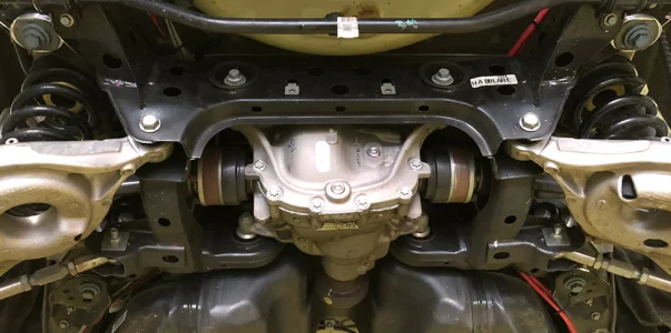

Which leads me to the s550 mustang IRS, in this picture you can see they added a big ass beam of metal also connecting the front and rear arms together. I’m no engineer but to me it seems they added it in order to reduce flex across the subframe. You can see how it wraps UNDER the axles. Once again, I believe there is some validity to the braces Dale has made
Thoughts??

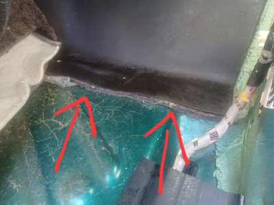

Still carpet cleaning, but this spot puzzles me. The foam (or rather a sort of pressed fiber type insulation) here is soaked, but only along the horizontal portion. Further up it's dry. It's completely colorless and odorless.
Any idea where this comes from? I would think a leak in the cowl would soak it from the top down.
Apparently it's impossible to remove that insulation from the car with the dash in place.

The rubber backing kept the coolant from soaking in, except on the bottom. That goes all the way up the firewall to the dash support. If you have time, leave the carpet out for a few days and shove some paper towels under there to soak up the moisture.
