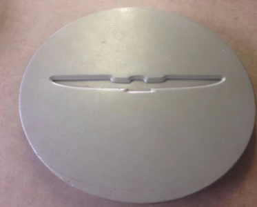

How does one remove the wheel center cap without breaking it? I mean the caps that look like this:
From standard (non-sc) 1994 Thunderbird 15" wheels. Mine are pretty much shattered already, but I wouldn't like to break them any further, especially if I buy a set of non-broken ones at some point.
I see that there's a small gap in the wheel which kinda hints you to push something into there. What kinda tool should I use? The driver's manual forbid using flathead screwdriver, and (IIRC) it told to use the flat end of the stock lug wrench, but I didn't succeed with that either.
The factory lug wrench is the right tool as it has the widest tip to spread the force from, screwdrivers are more likely to crack it or dimple the wheel prying. You’re best off positioning the lug wrench in the slot and hitting the end of it rather than prying, that should pop the cap off no problem
Thx for the tip, the lug wrench it is then. Gotta practice with the borken ones I have before looking for new set.

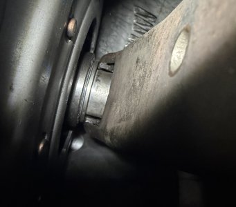

Hard to tell from the picture, but I have seen the input shaft sleeve break, which allowed the fork to move around, and made for erratic clutch engagement. If you grab the end of the fork that sticks out of the trans, you shouldn’t be able to wiggle it up and down much. If you can move it and hit the top and bottom of the hole in the bell housing that it comes through, then that piece is broken, and the trans has to come out and the front taken off to replace it.
