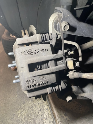

...upon closer inspection, it seems the zip tie was placed there to prevent the parking brake cable from slipping out of its receptacle. Not sure what to think about that.
Another question: I noticed on the rear left brake that the inboard pad is only half as thick as the outboard. What would cause that kind of wear?

Why would there be a zip tie here? Both sides. That can't be factory, right?

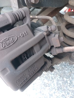

Yes, the zip tie is factory. When I rebuilt my factory original brake system a couple years ago, it had the zip tie on the left-rear caliper.
Here's a photo I took back then:

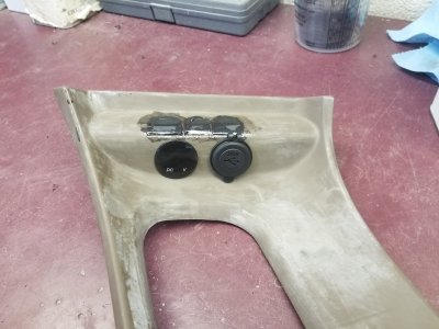

Has anyone ever modified/removed the 97 coin holder. I really A. don't need it, and B. don't like the look of it. I'm thinking about replacing it with sort of a small cubby slot, a place to hold lip balm, cough drops, etc.
I’ve been toying with turning them into switches, sticking a trio of push on/off switches stuffed inside to control a few things(fog lights, DRLs, antenna)
@97 30th modded his nicely for other functions
I like to think about a switch pattern killswitch
00011 = runs. Set to 00000 on park etc. Though I guess that could be awful if a switch was bumped in motion
