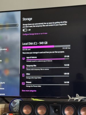

Question, not computer savvy in the least. My current computer (lenevo thinkcentre m910) has about a terabyte of storage. Is it possible to run an additional external storage device through a USB port?? Also, I’m currently buying cheapy games off of steam ( pretty much a place to buy games) would I be able to download the games on thy external device that way my computer’s storage isn’t used up?View attachment 17262

Thanks for the reply! I’m going to keep an eye out for a hard drive next.Yes to both questions. On the Steam one though, you'd need to point Steam to tell it where to install the game once you've added that external storage device.
