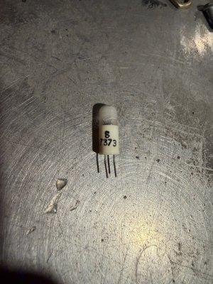

Played with it over the weekend, began troubleshooting in a failed state. It wasn’t until I touched the socket that it started working. Hmmm. Then couldn’t get it to fail again. I replaced the bulb with a spare I had.Yes! The Excursion was not lighting the left rear and when in service bay it worked fine. As they were backing it out and stopped I noticed the right was lit and left was not. They were like well I'll be damned. They were suprised but immediately went to the mfs.

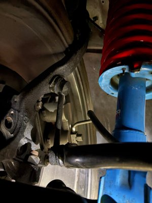

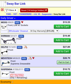

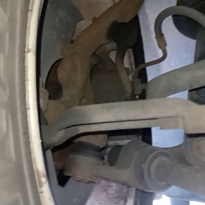

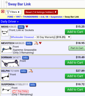

On the 94+, are the front end-links (sway bar links) really the ones with the bend in them?
Just want to make sure since I know that there's also a version of these that are lacking the bend.
Those look correct.On the 94+, are the front end-links (sway bar links) really the ones with the bend in them?

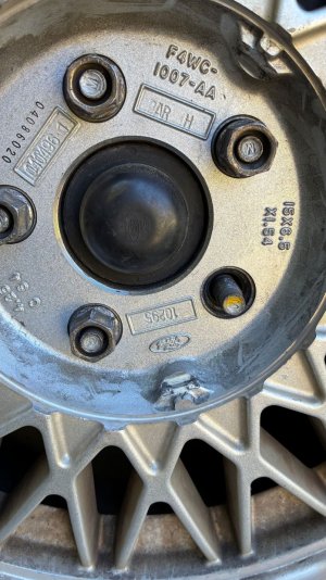

Not sure, but back in the day on TSTSNBN the theory was to line the wheel lug hole closest to the valve stem with the yellow stud to avoid vibration.Why does 1 wheel stud have yellow paint on it?
