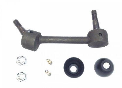

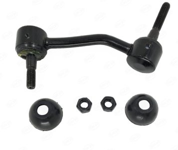

Anyone happen to know what the difference is on 93+ front sway bar links versus the older ones? I don't think I knew they were different and likely ordered for my 91. Thinking this may be why they fit like crap. I had just assumed the newer spindles were different in the brake mounting only.
93+ are angled differently
89-92
93-97
Pretty certain I have the correct ones, then. That early design is crazy.
Right? I had to edit my initial post after fetching the pics because in my head I remembered the early ones in a flat plane, but I must have been thinking of the link section and not the joint
they changed with the spindle change in 93. I bought a set after the stuck throttle incident. They are not a good fit for a 96.
I bought them from dirtydog, he assured me they would work,lol.
If you’re running 93+ spindles, you need 93+ sway bar links to match. If you ordered them for a 91, then they are wrong, but I don’t think you could even attach them to the later spindles.
I bought a set of 96 spindles, after I saw the difference.
I completely raped both a green Cougar, and a blue tbird over the years. When Lazarus got hit, I took the IRS and diff whole from the tbird, then got the decklid and rear bumper from the cougar.
I used the BFH to massage the fender back into rough shape.
I'm sure I have the correct ones as mine have the bend.
But not all 93+ had the bend in it. My factory ones didn’t have it and I’ve replaced them twice with straight ones.

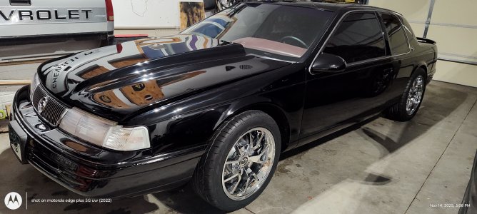

My spindles came off a 94. I can't search back far enough in my Rock Auto orders to be sure. It's a long story, but the short version is I had the upper control arms on the wrong sides. When I put the sway bar on it fit like crap so I had to lower it 1" at the bushings. Now that I switched the UCAs to the correct sides it sits high up front and I wonder if I need to correct the sway bar. 1000001834.jpg

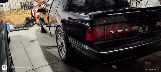

This is with a 1/2 coil cut in the front and is a good 1.5" higher than the rear. I can't imagine the front is more than 200# lighter than stock, so I wouldn't expect this stance. Sorry, not a good picture, but all I have of the side
Sport springs in front are putting 1000# per inch compression, 200# lighter might do that.
I should have noted these are 1.6" drop Vogtland springs front and rear. I have new spring cups to and bottom in the rear too. It's about perfect back there.
