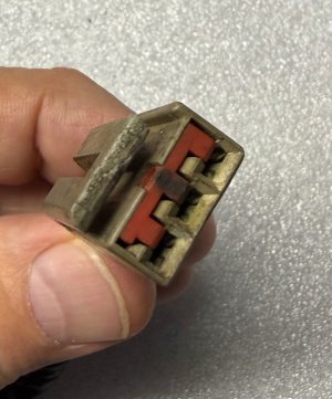

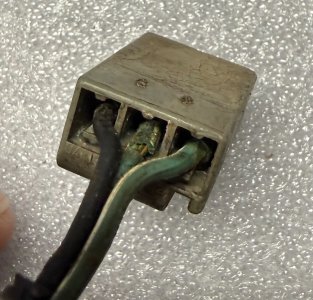

This is the plug for the brake fluid level sensor on top of reservoir. My current one crumbled in half. This was is a JY pick up. Middle wire is cut at plug.
Is it possible to repin this one? If so, how does it come apart. I am reluctant to just guess for fear of breaking it too.
On side note, I tried to search for new replacement but cannot find the correct PN. Would prefer that. Best I could find is that is comes with the whole replacement reservoir.
You pry out that red piece. It should pop out pretty easily. Then take a flashlight and look in there. You'll see that every terminal is held in the plug by a little plastic tab. Those are fragile. You need a tiny flathead, such as used for eyeglasses, or a needle. You release the tab, then pull out the terminal.
I've done it many times without breaking the plug, but I suggest you train yourself first using another unit that you can spare.
