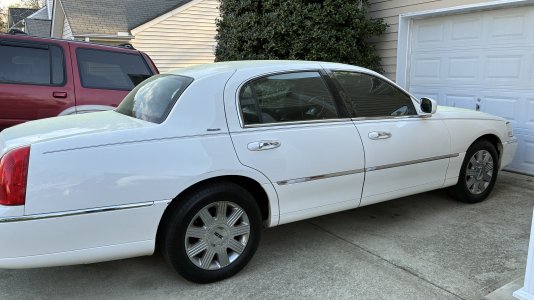

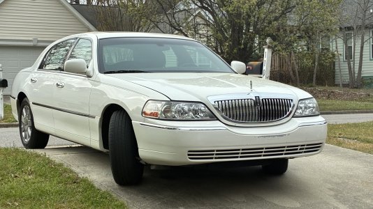

It’s an 04 Lincoln Town Car Ultimate w/ 120,664 miles. KBB estimates it at $4K. I know there’s an oil leak, I’m thinking rear main seal. The front lower control arms have recently been replaced. It hasn’t been driven except to the mechanic recently since about December.
To start any guidance on what to look at?

Here’s some more details. One of the techs that works for me, her farther recently died and this is / was his car. About a month ago she told me there was some oil under the car and when she checked the level it was way low, she filled it up and took it to the mechanic they deal with. He could not tell for sure where it was leaking, but said the lower control arms bushings were worn and suggested replacing the oil pan gasket. Her dad said to go ahead and do the control arms, but not the gasket. I’m going to ask her for that estimate to look it over again, she did show it to me when this happened and asked for some advice. I vaguely remember pics of the worn bushings. She will be selling it once the paperwork is in order and offered it to me first. I’ve not seen it yet. He was hospitalized for about 8 months hence not driven. I’m considering it as my daughter needs a better vehicle.
That sounds like a descent buy Kidd. I suspect you work on your Cougar so you should have less trouble with the Town Car. Heck, I rarely worked on my Town Car and as I have said before, the Cougar is the problem child.
The only advice I would suggest is skim over the Lincolns on Line web site for that year of car to see what people talk about the most about the car and I would do research on a descent price. I did some digging as well and the $4k price is average (for that mileage). But if it has rust, start knocking the price. You can fix an engine but body rust is a pain to repair. (old phrase from a neighbor)
