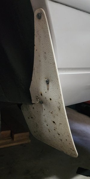

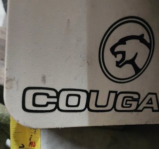

I’ve seen them both ways, the mud flaps with either the Tbird wings or Cougar head logos seem to be identical front to rear other than the holes for the bolts that hold them on
Lazarus had them, when I got it. I couldn't find a set for the red car in '05

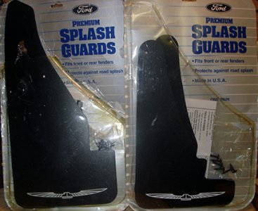

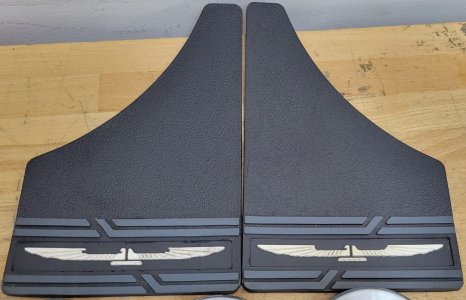

So I have a set, sort of. Here's what I have:
I took them in to a mechanic as part of having some other work done and told them to throw them up on there while they were at it. When I came to pick my car up, to my surprise they said the flaps didn't fit.
I could be wrong, but the ones I have appear to be these:
Which is F0SZ-16A550-A, 1987 date on the back.
I did some further searching, trying to see what various other part numbers were for. A search for F0SZ-16A550-B found an already-completed Ebay listing for "1990 - 1997 Ford Thunderbird Splash Guards White", albeit with no images. Nothing came up for -C.

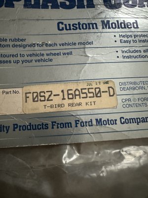

However, also existing is F0SZ-16A550-D. Perhaps these are what a 1997 needs instead? I'll have to look into it.
It's really hard for me to tell, because all the images of people with flaps from TCCOA back in the day are dead due to link rot. Can anyone with experience with these let me know what's going on with the various subtypes of these? And what a 1997 front actually needs? Thanks.

Wow, didn't know moulded was a thing back then. Mine were flat, and cut like Stanley showed above

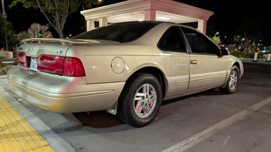

I bought them: that's a shot on my living room table.

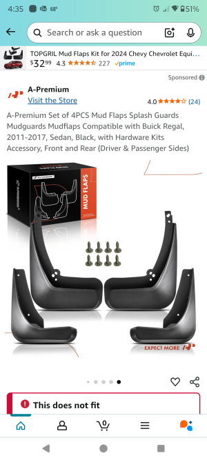

Reviving an old thread. Has anyone found short moulded guards that closely fit our cars? Something like this: 1000001292.png

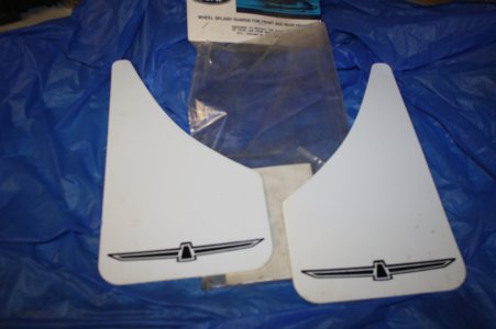

Now, I'm not sure, but apparently what my 1997 needs, for the rears anyways, is actually F0SZ-16A550-D?

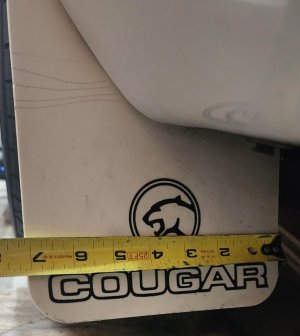

So those look to be what is on the 89 XR7 is bought a couple of years ago.
Oops, cropped the picture too small, the chopped off number is 14"

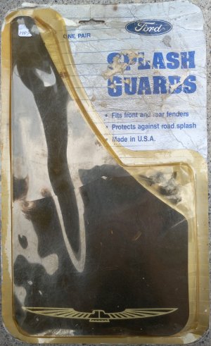

Decided to take some measurements and photographs. Click any image for larger size.
F0SZ-16A550-A contains two splash guards. I have a set here in the original packaging. They are 13.5 inches (34.3 cm) tall at the peak, and 7.5 inches (19.05 cm) wide at the bottom. They're listed on the packaging as being for both the front and rear.

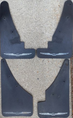

There's also some others that I've found picture of online. As far as I know, based on a post on TCCOA, both of those pictured below are for 94-97: left for the rear, right for the front. I have no idea what the part code on these two sets are (if you know, please post). I have a second-hand pair of the rights (front) and they fit fine on the rear of my 97.

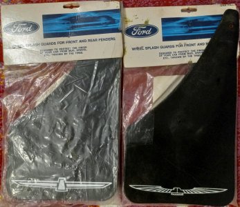

I also have two sets of E3SZ16A550-B, made for the 9th-generation Bird (83-88). As you can see, they are the exact same size as the 10th-gen flaps. So, if you like the look of the straight Bird logo, you may want to hunt down these instead.
Two bags of 9th-gen flaps, with a 10th-gen flap sitting on top of one of the bags to show how they line up (precisely, curve and all).
They were also available in white:

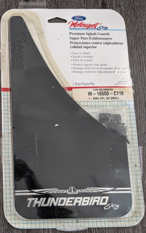

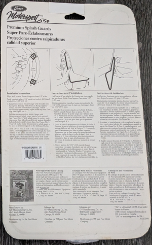

Then we have the SVO Thunderbird flaps.

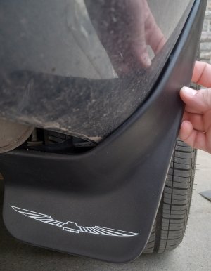

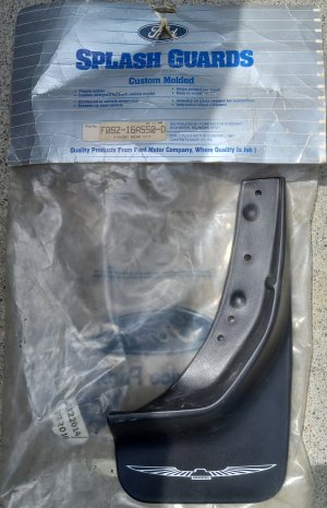

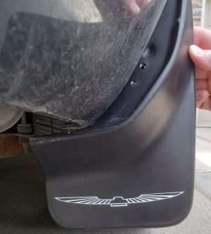

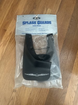

Bonus round. I also have a set of F0SZ-16A550-D. The packaging says "pliable rubber", but unlike -A they're more a plastic than a rubber--much firmer. Their packaging says they're specifically for the rears.
But while I was able to get -A to fit on the rears by drilling a few new holes in the rubber, these simply do not fit on my 97 due to the guard lip.
On the left is how they would need to sit if you wanted them to be aligned properly, and on the right is how they actually line up on a 97 Bird rear panel. So it looks like I'll be selling these.

I love those molded ones!
I wonder if they would fit an SC bumper. 🤔
I’m super interested in them.
If/when I put them up for sale (I still want to check the front for fit, on the off-chance it works), you'll have first dibs. But I'll handle that in a separate thread to keep this one just for info/reference.
If I remember correctly with the molded flaps, the fronts fit all years and the rears were year specific.
