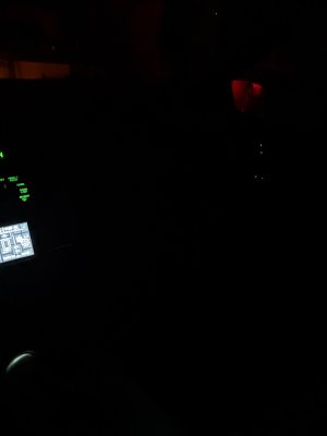

Hmm can you paint/dip the bulbs? I wonder if a mesh screen would look tacky
I’m going to try 1000 ohm resistors instead of the 470s to try to dim them back otherwise I’m switching LEDs. I wanted a little brighter than stock, not cartoon nuclear radiation lol

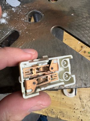

Since you've been in the switches probably more than anyway, do you (or anyone else) have suggestions on fixing intermittent switches? I had/have issues with only one direction of a switch stop working (like only rolling the window, or not being able to unlock the passenger door from the driver's switch). Since I have a couple of parts cars, I usually just rob a switch. In the past, I've bench tested continuity and everything works, only to have it not work in the car.
Have you had luck repairing switches? Mine is a 92, but the internals look similar to the pictures of yours.

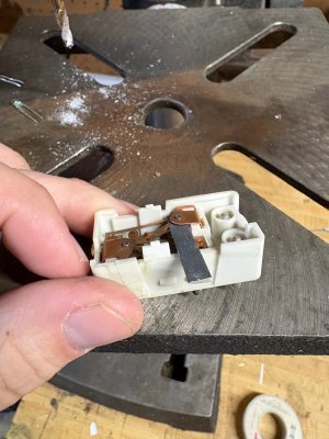

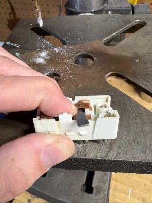

It’s probably corrosion, if you look really closely inside they have little contact points on each copper contact spring like a points distributer, likewise you could fold a piece of 400 grit sandpaper and clean them up the same way

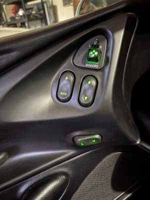

Alright driver side switches in. Not totally satisfied with the mirror switch LED, it still has a superbright one in it but the light path is a lot less harsh than the switches, so I think that’s the ticket for it. Here I will try a diffuser of sorts. Not entirely happy with the green though, so I might try a white or yellow superbright LED and a green diffuser to get it closer to the factory one.
I discovered this mod but I never bothered refining it til now 😆
Also, yay or nay on the “auto” switch? My purist side is clashing with my OCD side in that I do in fact have auto downs but I have them on BOTH sides. I could easily get two more switches that say auto but as a purist no Ford ever had that arrangement, let alone advertised. It’s basically this or the dual arrow switch as far as I’m concerned.
Also, don’t mind the light bleed from the mirror switch, I’m well aware. The rubber boot piece is torn on mine and I have a new one coming(mostly because I accidentally broke this one putting it together 😗)

Nice work Matt! I wondered what you were burning up switches for but you said not to ask. :LOL:
As someone who has no regard for purism, dual Auto switches. You already failed the true purist litmus test by installing one in an MN12 in the first place. May as well be honest about the dual auto down rather than misrepresent it because Ford didn't do it that way.

You know where I stand on the auto switch issue😉
Thanks!
The primary don’t ask reason was because I went back on a mod I did 10-15 years ago, retrofitting 2000s era Ford switches, which were a direct fit aesthetically but not in any other way. Now a days both are outdated and I’d rather have what it came with… I basically had to entirely rewire both doors this weekend just to have stock switches. 😆
Ok...never liked "Auto"-marked switches because they're showroom talking points. Once you bought the car and know it, you don't need that information.
But...it would totally irritate me to have  one such marked button even though  both windows are such equipped.
And the dual arrow switch only makes sense if the switch has two detents.
Oh, and I love the illuminated mirror switch.
It’s very easy to do too, Ford clearly designed the switch to illuminate providing not only the light path but even a cutout, terminal and pads in the circuit board for the requisite load resistor. AFAIK no model at the time with a similar switch ever had illumination, so it’s almost an Easter egg.
Also I’m going back to arrows for windows. Everyone’s made good points I’ve debated myself but looking at it tonight there’s a hot spot in the UT in aUTo that isn’t there in the simple arrow
Bummer. That's what I thought from your pix. They make 5mm programmable ones, color and brightness.
For current in an led, its v supply- vled/resistor. red leds are ~1.7, green 3.3, and blue ~ 4.2v.
1ma is a dim led, 10 ma is usually rated brightness, 20 ma is really bright, and lower life.red is 660nm, green is 532nm, and blue is 420nm.
