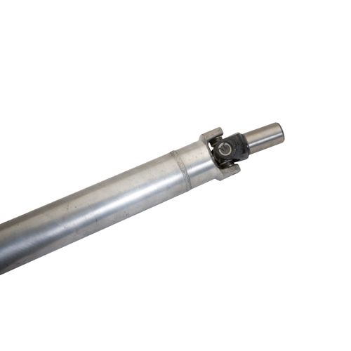

    Thoughts on the vibration at high speeds and testing the wheel bearings? I went through the front end a few weeks back for other vibration/rattles and could not find anything loose. But I might have found the culprit in the catback exhaust. I really need to get a descent exhaust put in some day.
    LOL. You found the "resonance frequency" of the crappy ass stock driveshaft. BTDT. The least expensive solution is a 3.5" aluminum driveshaft from Precision Shaft Technologies.
    I've bought 3 of them so far. :)
    I found the same problem as you did. If you don't fix it, it will waste your diff, transmission, and wheel bearings, I found. When I changed it out, it was in two pieces, delaminated from each other. The problem went away immediately. We had a group buy at the other place; when I bought the last one, they gave me the $450 price as the group buy. It's been 10 years, tho. The drive shaft length they want is center to center of the u-joint , which is listed in the trans forum.
    If by some small chance you can find a 93 mark viii ib a local jy, they have a one piece aluminum driveshaft. But that's the only way to find one cheap.
    I'd change wheel bearings before drive shaft my 97 will cruise at 90 with no vibration on a stock drive shaft with 350k miles on it motor and trans don't have 350 but orginal drive shaft. Finding a bad front wheel bearing is hard the old lift the car and grab the wheel doesn't always work due to the design of theses bearings so replace them and the rear ones which have to be pressed in/out.

    Wow, you guys are awesome. I would never had thought the drive shaft was an issue. I had the drive shaft balanced back in 2017 (10k back). But I have heard a lot about owners complaining about the drive shafts and what crap they are. As for the bearings, I was figuring that I would replace those anyway just due to the mileage on them and never being serviced.
    Thanks again everyone. Will be a while before I get anything replaced. But I will follow up.
    Thank you Grog, I am glad I am not the only one with crap rattling under the trunk. Now, $500 for a drive shaft is a bit steep for a tight wad like myself, so I will see what else I can find. Thanks for the insight Grog.
