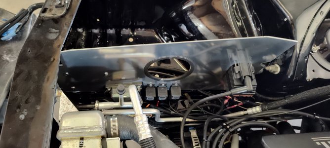

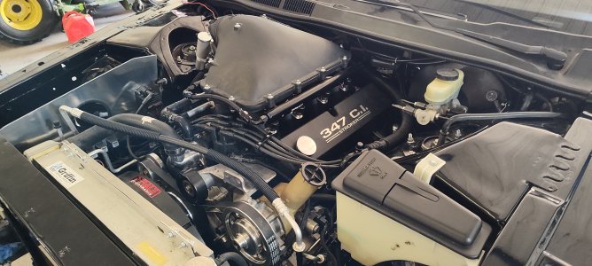

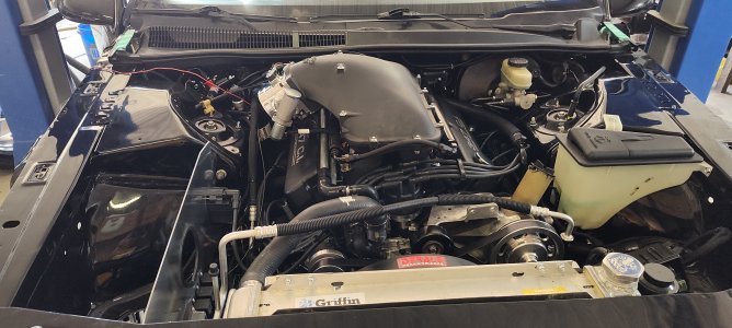

White smoke if you are lucky and watching your 6. Me however get to 4-way stop and then wonder what the hell when it doesn't want to go when revved to the moon. Yep. I learned they sell these adapter that arre barbed and they have a mechanical coupling w/ ferrule that tightens on the steel line and they are/were like $10 bucks in 2002.Fantastic work! It's inspiration for me to get going on mine. Thanks for sharing.
Keep your eye on that trans line fitting. I had one like that and after a while the hose slipped off even with a flare on it. White smoke in my rearview mirror gave it away.
