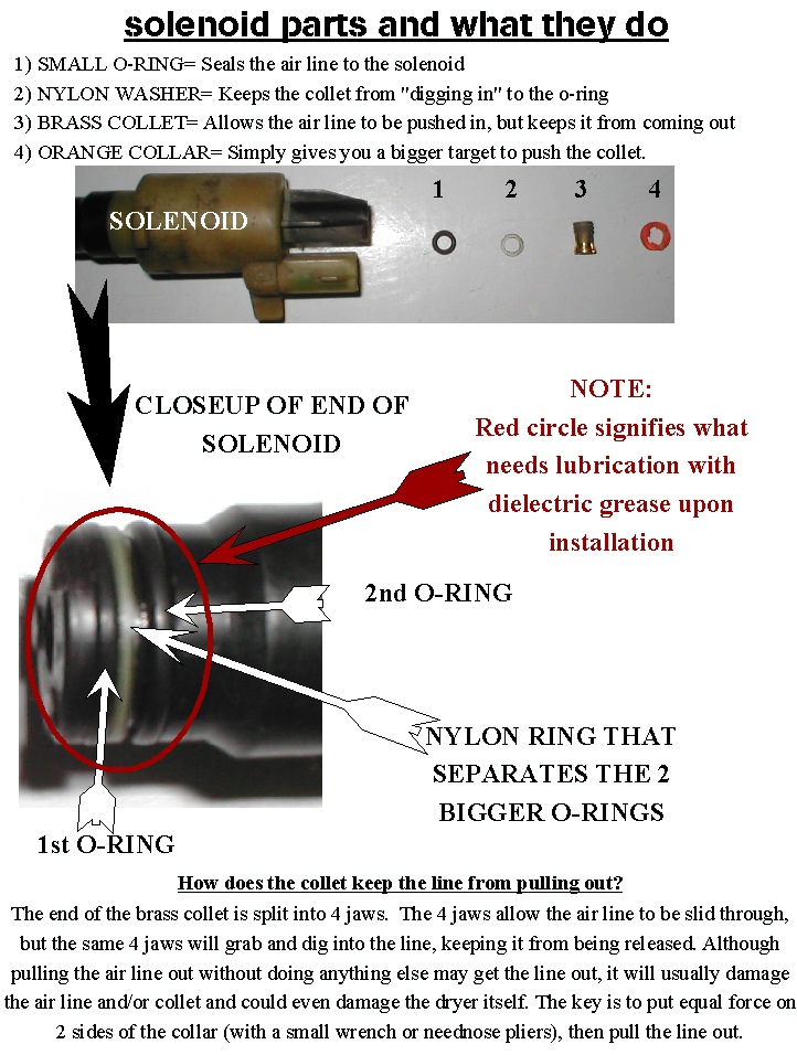

    All four air springs have an electrically operated solenoid that the module uses to isolate each air spring from the others. The module can control the left front and right front independently, but both rear springs are controlled together. The solenoids act as a gate for air. No air goes in or out unless the solenoid is opened by the module. All solenoids have a 2 pin connection which is a simple circuit of +12V and ground.
    The air line is held in the solenoids by way of a collet. The air line can be disconnected from the solenoid by pushing in on the orange plastic ring and pulling out on line.
    If the module determines the front or rear of the car should be raised, the air compressor will come on and the solenoids will be opened. Air from the compressor/dryer flows through the air lines and into whichever air spring until the desired height has been reached. When this height has been reached, the solenoid(s) will close and the compressor will shut off.
    If the module determines the vehicle should be lowered, the solenoid(s) on whichever air spring will be opened up, along with the vent solenoid in the air compressor. The vented air will pass out of the spring, through the air lines, through the compressor/dryer, then to the atmosphere. Once the vehicle has reached the desired height, the solenoids on the air springs and compressor will close.
    The module is programmed to only try to raise the vehicle for up to 90 seconds. The module is also programmed to only try to vent the vehicle for up to 45 seconds. If the vehicle has not reached the desired height in the allotted time, the module will time out. This means it will turn on the check suspension message and shut down the system. The vehicle will not try to make any height adjustments until after the ignition has been turned off then back on again. Once the ignition is turned back on, it will then try again until either the desired ride height is reached, or the system times out again.
    While these solenoids don't go bad that often, they do need to be resealed when removed. Click HERE for instructions on this.

    How to reseal an air solenoid
    First, TURN OFF THE SUSPENSION SWITCH in the trunk and put the car on jack stands.
    NOTE: Put the jack stands under the frame, not under the control arm!
    Disconnect the 2 pin electrical connector and then disconnect the air line by pushing the orange collar in towards the solenoid body, then pull the line out. If the line has never been removed, the brass collet may be "dug-in" to the line and may require some patience. If it doesn't want to release the line, try pushing the line in with one hand while pushing the orange collar in with the other hand.
    To remove the solenoids, remove the safety clip that keeps the solenoid from accidentally twisting. You can do this with a flat head screw driver.
    Twist the solenoids till they stop. The solenoid has a 2 step removal process. After it has been turned to the first stop it will be ejected slightly and ALL THE AIR IN THE SPRING WILL RUSH OUT VERY QUICKLY. If they've never been removed before, you may have to help twist it with a screwdriver or something. Take care when doing this; the solenoid "should" stop at the first stop but it can still pop off and hit someone in the head. Turn your head when you twist the solenoid.
    After the air has stopped rushing out, twist it again and pull it out. Pull off the old o-rings and replace them with the new ones that have been lubricated with dielectric grease. Install the 2 new o-rings while keeping the nylon washer between them. Dielectric grease doesn't seem to attack the rubber like petroleum jelly. If you don't lubricate them with something, they will bind and probably won't seal as well as the old ones, which means you did all this for nothing.
    To replace the o-ring that seals the air line, first remove the orange collar. Then carefully remove the brass collet (it's easily crushed) and remove the little nylon washer, then the old o-ring. See picture below
    Install the new, smaller o-ring in the hole of the solenoid, making sure it's flat and seated, then the little nylon washer. Make sure both are flat and seated. Install the brass collet and then the orange collar.
    After these o-rings are replaced, install the solenoids, plug in air line and 2 pin connector then remove from jack stands.
    NOTE: Install the air lines into DRY.
    We DO NOT recommend using ANY type of lubricant when installing the air lines into the dryer or solenoid for 2 reasons:
    #1) The lines are held in by way of a collet. The small jaws of the collet hold the air line into place. If you put a lubricant on the line, the line could pop out and would result in a major leak, which would allow the front and/or rear of the vehicle to lower all the way down to the bump-stops and most likely do serious damage to the compressor.
    #2) The air line o-rings are NOT designed to be in contact with ANY foreign substance! In other words, using a lubricant on the lines on installation will almost certainly cause a reduction in the life of the sealing o-rings, thus causing a leak.
