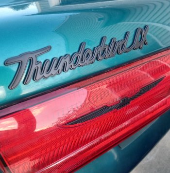

The chrome birds on my taillights and the "Thunderbird LX" lettering on my trunk emblem have weathered and are looking sad, so I'm planning ahead how I might deal with this.
Do you guys use high quality modeling chrome paint (I mean the expensive shit that shines like plating), paint 'em black, strip 'em and leave the base black matte, paint 'em the color of your car, or do something else?
Got any before & after pics of your solution to share?
