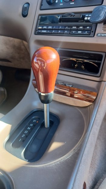

Picture of that Mustang knob? Sounds interesting.
Yes, with some minor modification, you can use essentially any shift knob which sits on a half inch rod and which pushes the center lock rod down (which would exclude adapting any VW group knob as they pull the lock rod up).
Many knobs, including my Lincoln LS one, require drilling a small hole into the rod to secure the knob with a screw, or two holes/screws if you want it to be "factory". I have a detailed how-to thread about that installation in the Interior section.
If you have a talent for leather stitching, creating a custom, snug-fitting boot would be a nice project. That's still a possibility for me, though I like my current look. A boot could also hide O/D button wires.

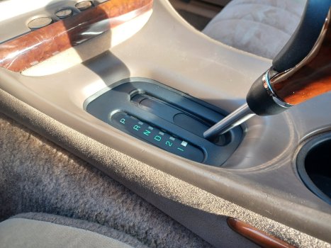

I like the exposed metal look below my LS shift knob:

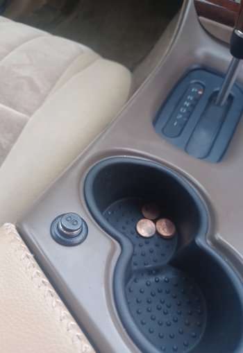

My O/D button is currently aft of the cupholder. I put it there because I used the prewiring for traction assist, which my car doesn't have, so the installation was very easy. But it is awkward to use. I'm thinking I'd like for it to be right above the rear defroster switch.
That shift knob looks nice! It wouldnt match up with the way my interior looks but if i had the other colors and wood panels i would do that
The same knob also exists in various colors leather as well as gloss black, gloss red, etc., because it was also used in the Retrobird. It doesn't have to be wood.
