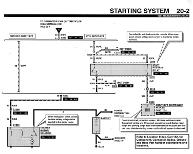

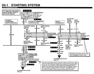

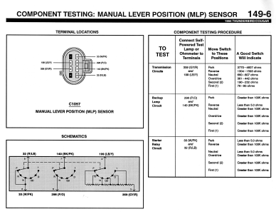

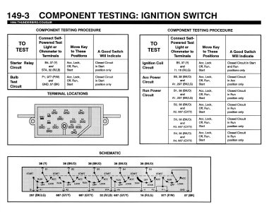

This morning I went to start the car, turned the key and it was completely dead. Ignition lights came on but didn't start. Battery isn't flat. Tried two or three times and nothing, then the next time it starts s normal. I didn't manage to hear if there was any clicking when I tried the times it was dead as I had the windows up. I'll see what happens later when I have to start it again.
I know my ignition switch is worn, just wondered whether that could be causing this, or if it's the starter.
