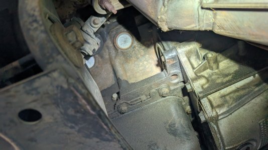

Im under my Pearl Bird to get a better visual since it's all taken apart right now, and I see the freeze plugs but not the hex bolts freeze plugs. Could it be different?
Passenger side: both seen easily here. The one on the left is partially covered up on the left
Driver side: it's harder to see, but there are two in this picture. One behind the starter and the other to the right of the little red nub of the starter.
NOT the freeze plug. The drain is a ~10mm plug, threaded into the block. Look at Matts pic.

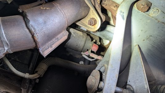

It's in your 2nd pic; I'm wrong about the allen, thats the oil galley plugs. It's a 10mm bolt just above the wire loom in #2 pic.
No!!! That is a cross bolt for a main cap, do not remove that! The side the starter is on isn’t accessible at all, it’s underneath the motor mount bracket in the V of the engine(there aren’t coolant passages in the skirt of the block)
Circle where it's at in my pictures, please.
I have not seen a hex bolt anywhere.
