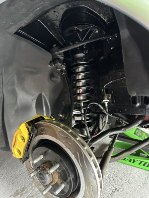

Doing some research it seems that no one has anything bad to say about the SCP QA1 front coilovers. In fact everyone seems to love them. I know there are concerns about no bellows which I plan to address.
Parameters for the car are it can't ride like a covered wagon. My wife drives this most of the time and we live in Michigan so I do not want to overlook ride/comfort. That said, it would be nice to lower it a touch (maybe 1") and I wouldn't be averse to some improvement in handling. A firm, but not bone rattling ride would be acceptable.
So, my thoughts were SCP QA1 front coilovers with either 400# or 450# springs (open to suggestions here). That at least seems to be a good starting point. When I first saw them I thought they were ridiculously expensive, but if their performance is good and the shocks themselves can actually be replaced and/or rebuilt then that is a positive in my book.

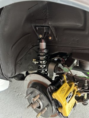

I don't really want to go to the QA1 rear coilovers for reasons that have been discussed here and elsewhere previously (single shear lower bolt, putting all the weight of the car onto what was previously just a shock mount, etc.)

Anyone have any input on the front spring rate on the QA1 coilovers? It looks like the factory Sport springs were a progressive 350-400#. It looks like Afco has a 375# spring that would work with the SCP coilovers.
Ah right. So I might as well roll the dice with the B6 shocks and see how they feel,
I seem to remember them working out better with 550# springs.
Dredging this back up. Getting ready to pull the trigger on suspension and brake parts for the T-Bird. Going with the SCP front coilovers. Still cannot decide on a front spring rate. I was going to go with the 375 lb/in springs to mimic the stock SC springs as closely as possible, but I hear many people saying those are too light which makes no sense to me. The shock mounts and acts on the exact same points as a stock shock, so it isn't like we are changing the motion ratio so the wheel rate should be exactly the same (okay within reason because factory springs are variable rate, but you get the idea) as stock SC springs/shocks. What I am trying to avoid is putting 450 lb/in springs on it, having it ride like a covered wagon, and having to spend another $200 on some lighter springs. Keep in mind, this is a daily driver (by my wife) in Michigan.
I've got 500# on mine and it rides great, roads here in Ohio are about like they are up in Michigan. Mine is a 5.0 (dart 363) so it is a little heavy. I'd go at least with 400s if not 450s.

Eric, I think you said in a previous PM that you were running 450# springs. Man those just seem heavy, but between you, Adam above, and everything else I've seen, I guess I'll give them a shot and see how it goes. Appreciate the feedback from everyone!!
I'm just going with the front coilovers for now. Rears are going to be 1" drop Vogtlands with some fancy pants QA1 adjustable shocks.
Also FWIW, I know a lot of people have some apprehension about the single shear rear coilover lower mount (including me), but I did see that Maximum Motorsports also has a rear coilover for the IRS Mustangs that uses the exact same type of lower mounting point.
