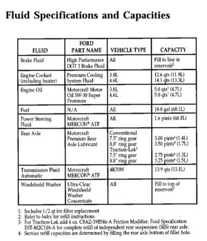

And as far as PS fluid goes, I know ATF is the best fluid to use, but which type is it again? Mercron VI? And how much fluid should I grab for full replacement of fluid, 1qt?

Fluid capacity is in the manual; should be less than a quart.
