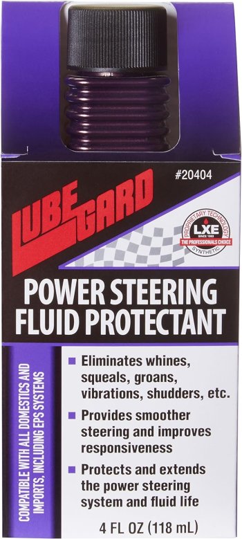

On my 96 Tbird I did a partial Mercon V change and added this stuff... It was fairly quiet after that but still had a bit of whine.
