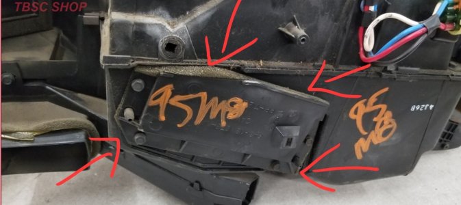

That is correct and makes it a b*tch to insert new core. Even when lathered w/ dawn detergent. I wound up cutting mine on side near fender to give more room as the core goes straight in according to the slot in box. Thankfully I've only had to do this once in 381k miles.The gasket is sandwiched between the firewall and the heater box and larger in size than the hole the core passes through.
I drilled a tiny hole into the bottom of the heater core housing. About another half cub of coolant came out.
For those of you who have done this, is there usually coolant pooling up in the evaporator housing? That seems to be the lowest point, but I'm not comfortable drilling into it. I'm worried that the evaporator is swimming in coolant.
If there was any fluid discharged into the evaporator housing it should have drained out the drain port through the firewall the same way excess condensation from using the A/C would.
I have to say that my A/C has never been this cold before. I'm guessing that, even with the blend door set at full cold, a 200°F heater core in the immediate vicinity of the airflow always caused some minor heating.
