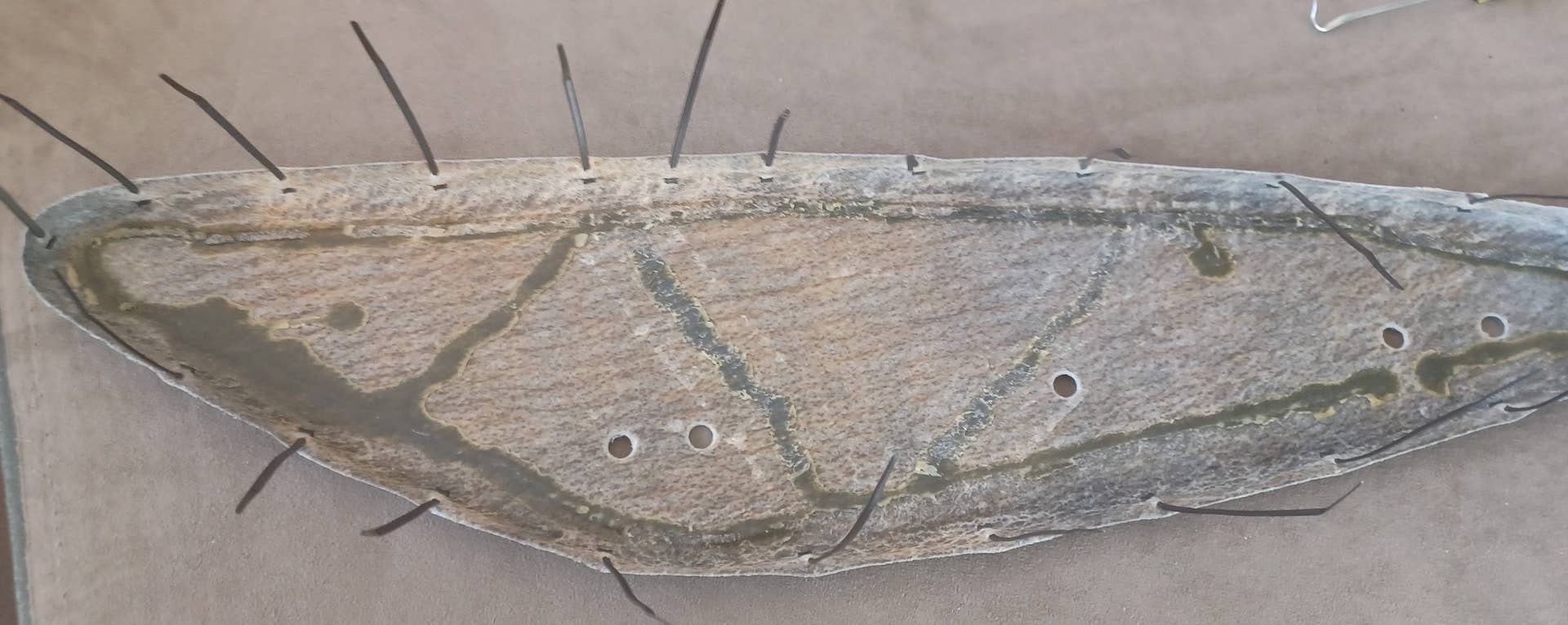

  • place marks all around the carrier layer as well as on the door panel mold.

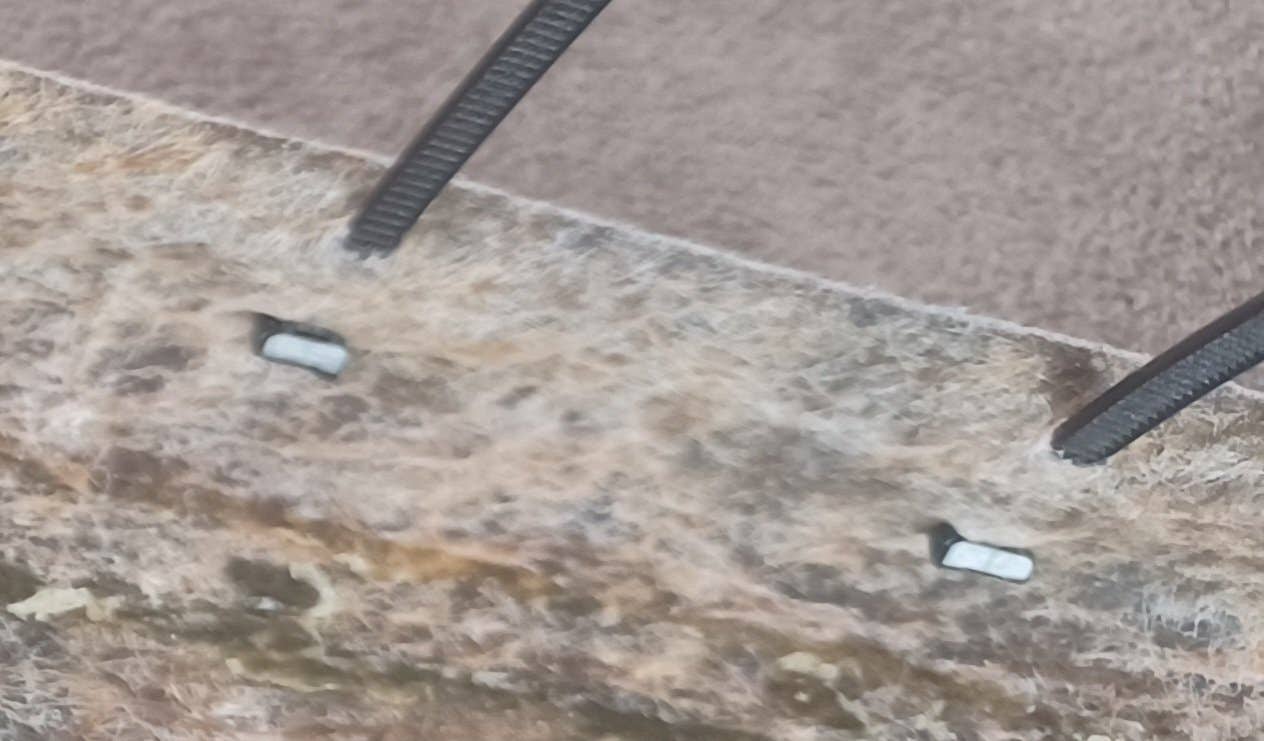

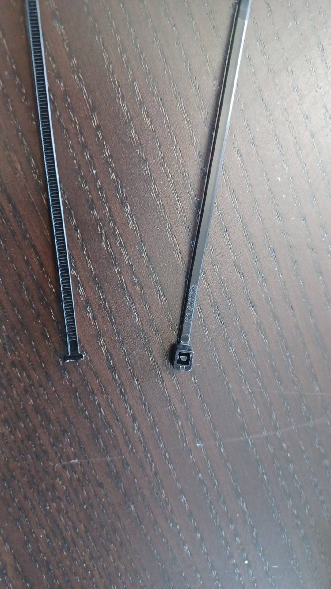

  • cut off tiny zip ties as shown
  • poke holes and place the zip ties along the carrier layer edge at each mark
  • glue cloth to the carrier using double-sided carpet tape and cut along the edge

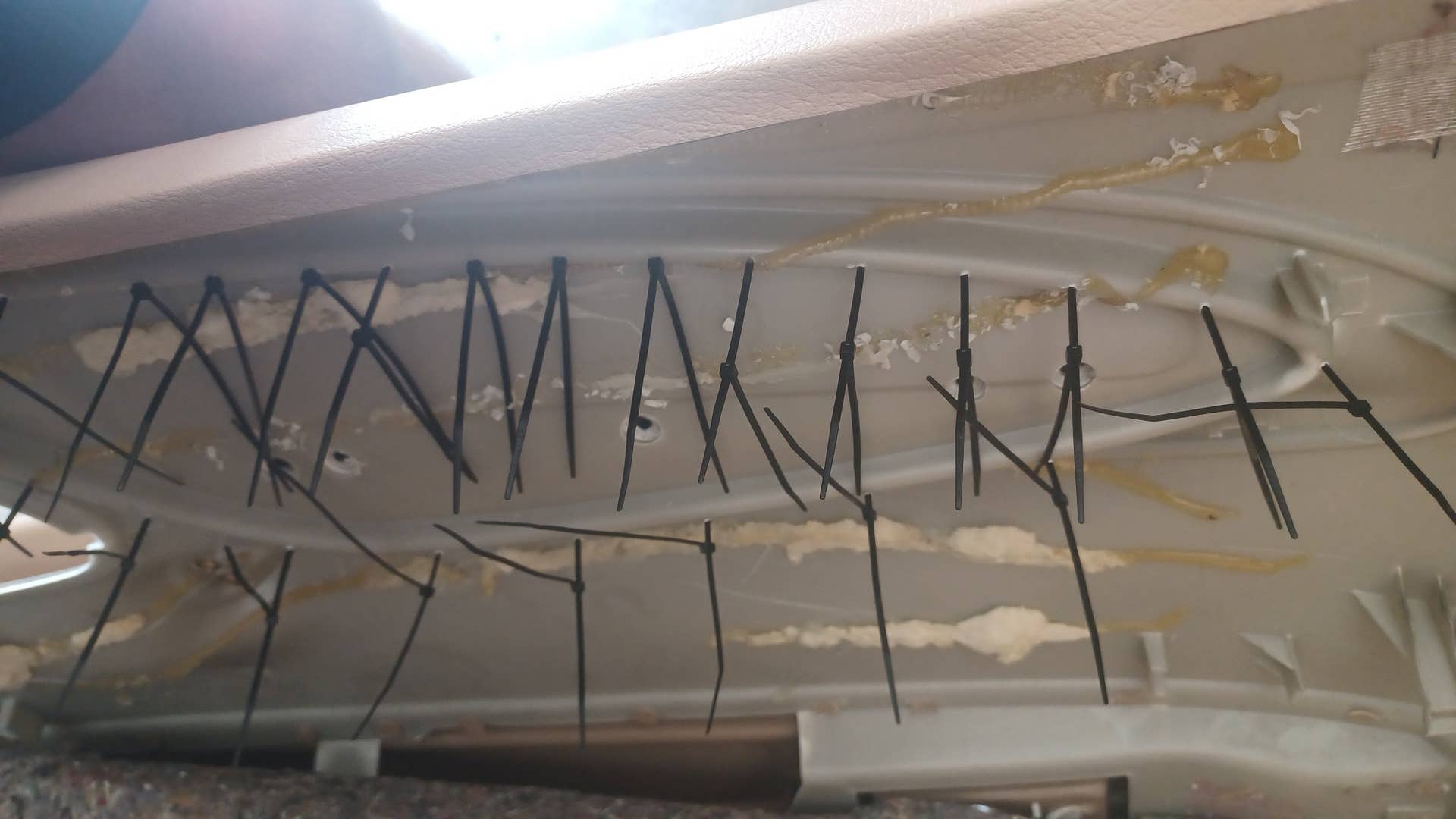

Step 2
  • drill tiny holes around the door panel mold at each mark
  • place the new trim piece onto the door panel by feeding each zip tie through each hole bit by bit
  • lock in place with more zip ties
  • cut off zip tie ends

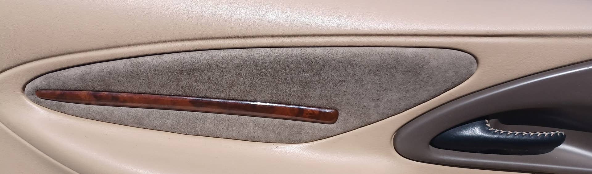

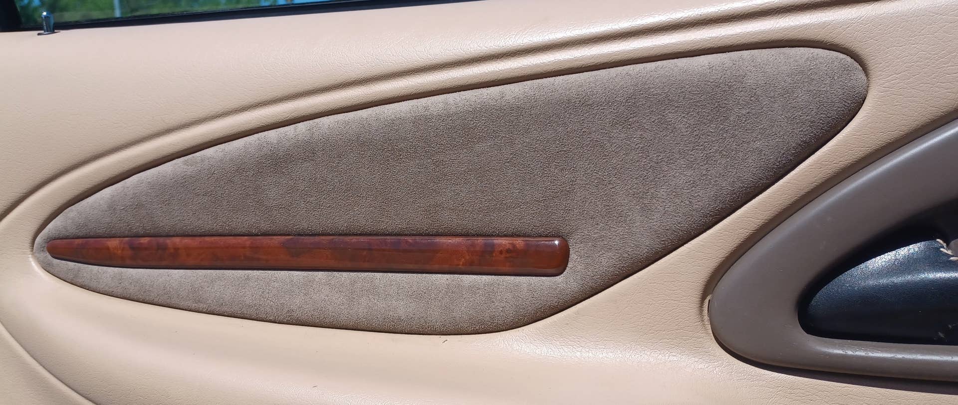

Enjoy your door trim which is now solidly attached and firmly seated:
20230418_115647-jpg.53217
20230418_115638-jpg.53216
