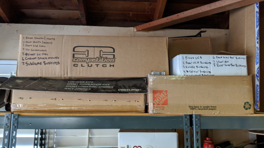

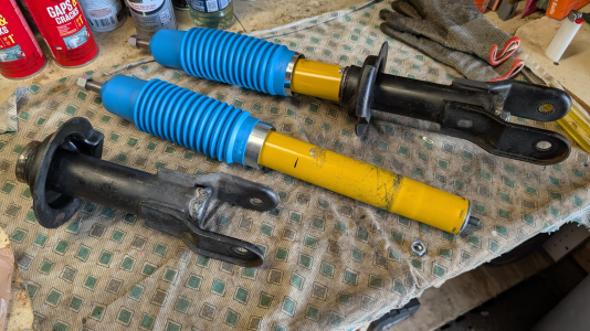

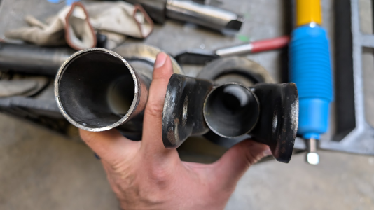

Just about everything in my suspension list is bolt on. The only part that requires custom work are the spherical bearings being installed in the shock mount for the 3000GT insert mod.
