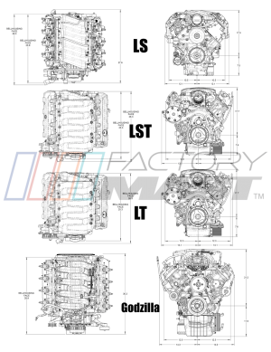

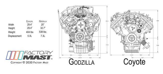

I love a good 5.0 Windsor. But if you have the kind of budget you mention. You could consider the 7.3 Godzilla. Those are 444HP out of the box. they are all aluminum and they are not large. And they are available in crates for 9-10k. Just a thought.
And there is a good selection of go fast parts for them now too.

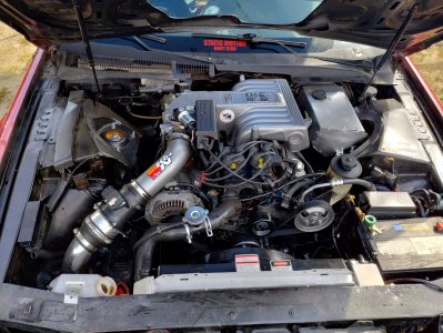

If I do the Teksid 2V I know it won't hit the 500 goal. Maybe Low 4s. But at least that is nearly free, since I have basically everything. Headers, oil pan, 8 bolt crank, comp cams, PI heads, and another SVO. I need pistons and rods, and gaskets and bolts. But even then, I'm not wanting it.
The problem I see for your use a SVO is a big heat pump without an intercooler, that’s perfectly viable for street/strip but I would expect in a drift environment it might be problematic.
Its nearly guaranteed. There's one guy there who runs a non IC blower set up, a 1UZ with twin M90s. I'll have to talk to him. Probably will need water meth if I go that route.
