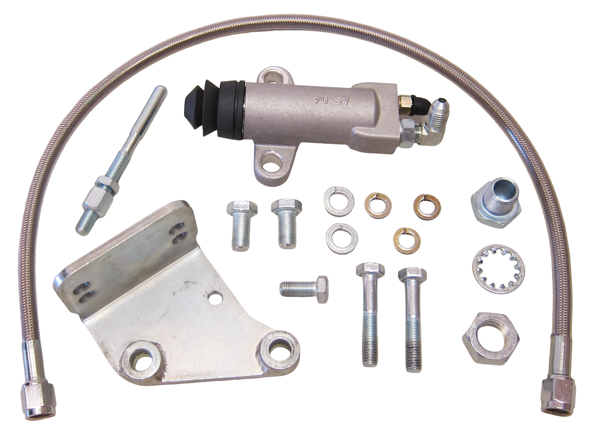

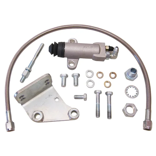

It’s an MDL slave cylinder.
Ok. Based on the picture, the same method should work.
Completely remove it from the trans? Do I leave the line connected?

I looked up the MDL T45 slave kit, looks like a nice unit, if I were to do over my setup I would probably go the route. I spent many hours dicking around with a bracket and linkage with the S10 slave.

Yep, that’s the kit.

The pedal does have feel to it, and I can see the fork moving when the clutch is being pushed, it seems like it not pushing enough though.
That’s your problem. You need a 5/8” bore slave cylinder. The 3/4” one will never have enough throw with the SC master cylinder. Get a slave for a 94/95 4-cylinder S10 and make a new bracket. That slave you have will never work.
All I can suggest is maybe it needs to be adjusted, looks like the kit comes with an adjustable rod. Sounds like you have the thing bled fine.
Mike is probably one of the most if not the most knowledgeable on these swaps. If he is saying that kit isn't going to work, I would tend to believe him.
Maybe at this point you should contact the company and see what they say about the situation?
@MadMikeyL is it not going to work because of the clutch master used on our cars, or is it a flawed product?
Edit... I just reread your post and you already answered that :facepalm:
That sucks the kit won't work. On the bright side, if you aren't able to return that slave kit you can probably use the bracket as a good starting point for the S10 slave mount

Yeah, I don’t know what master that kit uses, but I’m willing to bet it would be harder to make their master work with the MN12 pedal/firewall than it is to make a bracket for the S10 slave.

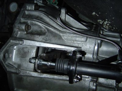

So over the summer I made a bracket for the s10 cylinder and had it all mounted up, then I decided it looked ugly so I did some research and found the MDL kit.
I got the MDL off and got my ugly built s10 cylinder bracket on, I called it a wrap for now. Hopefully I’ll have it finished tomorrow.

I’ve been at this for a few hours now, and I still can’t get a pedal. I’ve bled the clutch, I removed the slave cylinder and hand pumped it a ton of times. Still no luck!
The spring inside the slave pushes the throw out bearing up against the clutch fingers. So if there is any gap, that means your slave is already at the end of its travel. You should adjust the pushrod so that the piston in the slave is almost all the way bottomed out at rest.
