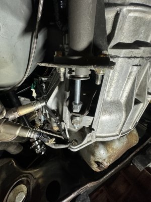

Ran into an issue with the T45 swap, the car will shift though all gears perfectly fine, but it gets stuck in reverse and it’s extremely hard to get it out of reverse, I’m assuming the rod I made for the slave cylinder needs adjustment, but I haven’t gotten to that yet. I’m open to suggestions on what else it could be.

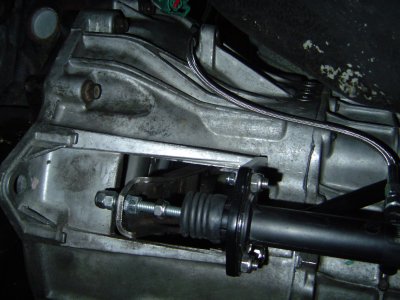

Then it isn’t internal in the trans. Likely the clutch isn’t disengaging all the way. Does it engage really low? For the S10 slave to work best, the pushrod should be pushing on the part of the fork where the cable usually comes through, not where the cable would be resting. I use threaded rod to be able to adjust it, lock 2 nuts together for the adjustment, and drill out an old lug nut to fit over it to act as the pivot point on the clutch fork.
Yep, it does grab very low. I believe in have the threaded rod coming through the outer most hole on the fork, I planned on jacking the car up and make some adjustments. I’ll report back when I get it done.

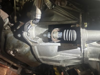

The drilled out lug nut is on the wrong side of the clutch fork. The cone section should sit in the hole in the fork. Also put the boot back on the slave cylinder. You’ll have to trim the tip a bit for the larger diameter rod, but with no boot, road debris will get up in there and the slave will start leaking.
How does this look now?
