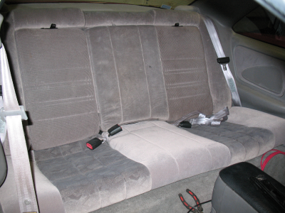

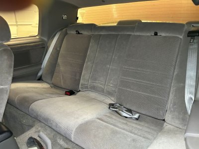

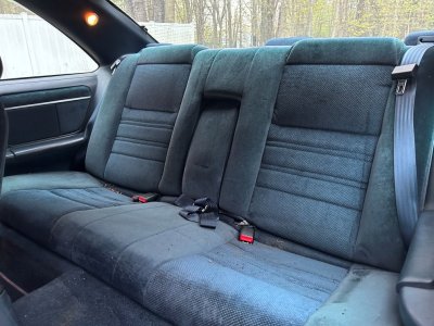

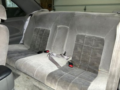

Stupid rear seat question. I know from the shape of the fold-down rear seat upper half that it's different from a stock Thunderbird rear seat. I also notice that the stock Cougar seats look different from the Thunderbird seats, at least the couple I remember looking at, the shape is more rectangular, less curvy.
So, my question, for a potential fold-down rear seat swap (if I can ever get my hands on one), are the lower rear seats different in terms of foam padding shape? I would think they would have to be to better accommodate the upper half resting on them. But, are the stock Cougar rear seat lowers the same shape as the XR7 or whatever fold-down lowers? They seem flatter than the Thunderbird stock seats. Or are the fold-down rear seat lower halves a unique shape for the Super Coupes and the XR7s? I'm also assuming the lower halves are consistent from like '91 to '97 for each car model but that's just a guess.
The foam shape is different, but I think it's a difference between 1st gen and 2nd gen seat designs more than it is Cougar vs. T-bird molds. I do remember the lower part being curved up at the back for the middle seat; I never installed it because I wanted to keep the stock 97 seat belt arrangement (where they come up through slits in the seat bottom, rather than through the gap between the bottom and back).
I briefly had an early XR7 fold down seat back with my stock 97 seat bottom, and it didn't line up quite right. All the same, I had them reupholstered to match and it's not too bad.
94-97 Cougar rear seats use the same foam/pattern as the SC rear seats, so yeah the bottom would be a good match with a fold down upper

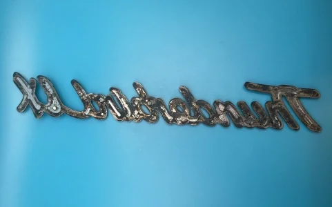

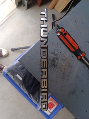

Where exactly are the holes on the 96/97 trunk lid behind the Badges? (Pics please.)
I'd like to replace the cursive Thunderbird with this, as well as the Ford oval with the "LX" badge.
It might gain something, but likely not worth the expense and aggravation of the swap. The combustion chambers on the 3v head are slightly larger than the NPI, so you would lose a little compression. You will also lose significant mid-range power with the cams locked out compared to the stock 3v motor. Plus you have to deal with the different layout of the intake manifold and possible exhaust manifold fitment issues. You would likely make more power for less money with just a PI top end swap.
Thanks! I was wanting to get rid of the heads and was kinda going hmmm? Found a complete '07 2v engine on market place for $850. Thinking I have an engine swap coming since mine has 369k and I believe I'm eating the chain guide on right side. So at least it already has the pi heads but dished pistons.
...and to elaborate on my question: are all the holes in one straight line, or do some sit higher/lower?
I think the hole for the T is higher up than the other two. I remember ages ago at TSTNBN someone used the retro Thunderbird emblem in place of the 96-97 one and it perfectly covered them
The badges are on with tape on my cougars. Unless you're talking about lights.
Apparently there's a pin at the top of the T and the bottom of the L. That is a problem for my idea, because the emblem I want to use wouldn't cover both. Too bad...
I really wanted to get rid of the Ford oval, and I also don't like the font of the stock badge at all.
I'd grind the pin off 3m tape doesn't let go easily.
If you dislike the font, look for emblems on ebay or amazon.
