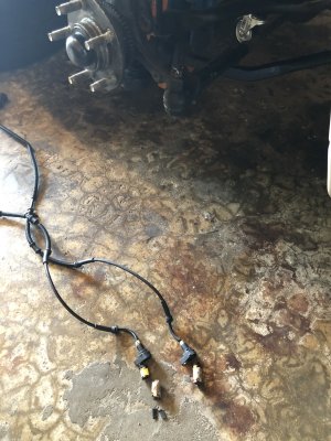

I've never removed a Ford wheel speed sensor on any car without destroying it. You are in good company.Not that it matters but has anybody EVER gotten the front ABS sensors out of the spindle without completely destroying them? Because I sure haven’t! But the ones on my car looked so tantalizingly clean I delusionally thought they’d just slip right out.
RIP
Would you mind taking some measurements of the cable lengths and posting pictures of the connectors? I think similar year Crown Vic wheel speed sensors could be made to work on our cars.
I don't know why they do that, but everyone I've ever worked on is like that. I know you don't need them, but I swear Crown Vic wheel speed sensors could be made to work on our cars with some wire length adjustments and they are readily available from the aftermarket.
RIP
Oh yeah, I absolutely bet that would work. At 31” you could make a shielded 7-8” extension jumper cable to make up the difference very easily.

I was able to pull them from my Town Car, but it was some work. Lot's of PB Blaster, patience and luck.Not that it matters but has anybody EVER gotten the front ABS sensors out of the spindle without completely destroying them? Because I sure haven’t! But the ones on my car looked so tantalizingly clean I delusionally thought they’d just slip right out.

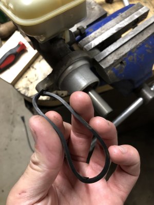

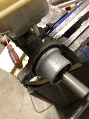

Can you get some rough cross section and ID or OD dimensions? McMaster sells square cross section O-Rings. It looks like maybe a .203" cross section, but could be metric.Minor snag in my project, does anyone know the Ford part number for the gasket that goes between the master cylinder and booster?(93-97 ABS/96-97 4 wheel disc) I went to see if I could find a large O ring to fit at the hardware store tonight but no dice. I have a solution I know will work(room temperature vulcanizing compound), buuut I’d like a less messy solution
