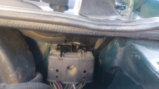

New question: is it normal for this connector to get wet during heavy rain or washing the car? Seems like a poor design choice.

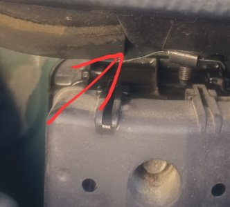

Note the gap in the foam insulation. Could some of you check if you have the same gap?
Thank you, Matt.
And yours is the round one. Interesting that they bothered to change the firewall at some point (I'm guessing '96).

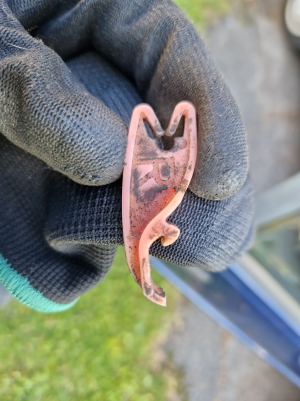

Yes, and it seems at least one name for it is "Door lock pawl/lever/clip/retainer". Found it from eBay now: https://www.ebay.com/itm/385388458873That looks like the piece that pivots from the lock cylinder and moves a lever to actually unlock the door. If I remember correctly the lever goes in the clips. The other side does look broken.
