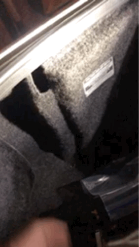

What other 4.6 platforms or year ranges have the green and red hoses that I could take from?
Given the break happened right at the junction I’d just pluck the broken off stub left in the rubber out and and slip the remaining green line into it
Actually looking at it it looks like it’s already been bodged at some point, it looks like the green line is only a stub itself with a rubber hose in place of it. From the factory there should be loom over both the red and green lines all the way
