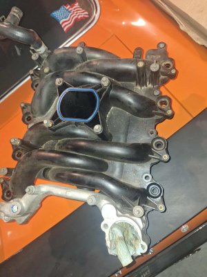

It looks like it
That's the picture.

Definitely a PI. Looks to be in good shape.

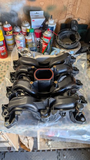

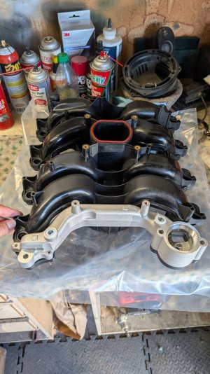

The aftermarket ones look like this. Notice how the intake runners don't "overlap" with each other. Also, yours will require new intake manifold gaskets whereas mine already has O-Rings built into it at the bottom of it and won't require gaskets.

So looking at that one is there something you think I should look for specifically?
Like I said, make sure there's no cracks or breaks anywhere, specifically at the bolt holes to the head (there doesn't appear to be any in the picture, but better safe than sorry). Check for cracks at the coolant cross over pipe.

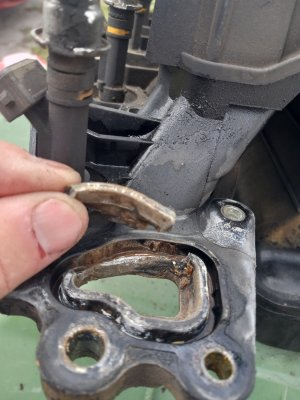

2 wrenches. Each on opposite bolts. One right and one left.
I stick a screwdriver between two bolt heads while I break tem loose 1 at a time. It takes practice but a flat blade catches the Bolt head pretty good.
Like this!
