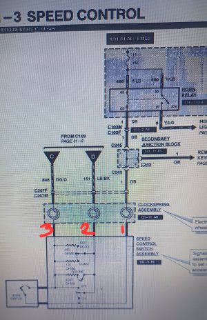

Ok, someone explain to me how this works, because I want to understand it.
I gather that (1) is always-on 12V from the horn relay. And I gather that (3) is a ground, needed to close the horn relay through the horn switch.
I also imagine that (2) is some hit-in-run voltage which flows through varying resistors to provide a signal to (3) for Set/Accel, Coast Resume, and Off.
But what I don't understand is how On works! Based on this diagram, On conncets (1) to (2), so power to power?! How can that constitute any kind of signal?
Also, does this mean, theoretically, that you cannot use the horn and change cruise settings simultaneously?
Basically, you can actually honk the horn with the cruise switches on 94-95s lol 😆

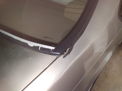

What's the right kind of adhesive to use on a c-pillar moulding that no longer stays in the groove? Seems every time I try to rebend it I get further away from where it should be! Thanks.

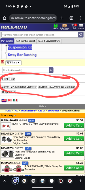

My mechanic just let me know that he needs "front strut bushings: from lower control arm to rod, not from rod to frame."
He says all he can find is plastic. What part is that and are there decent aftermarket replacement besides the plastic available that I can get somewhere?
The bushings in the control arm don't matter. Put whatever you can get in there.
I'd rather do higher quality, if I can. If they went once, they can go again. I'm trying to find the precise part this is, though, and am having troubles.
I guess I'm just saying you can use either thermoplastic or regular rubber in there. It doesn't care.
I get that, in general, but since I've heard so many horror stories about the plastic front-end bushings failing in a relatively short period, I'd rather just do it once with something that's going to last for a while instead of shattering while I drive or spending money on the labour again a year down the road.
I don't think anyone has ever had the thermoplastic bushings in the arm fail. I've had the Moogs in the '97 for several years and probably 60k miles.
The control arm side ones can be either material, and the thermoplastic hold up just fine. Actually I would argue the thermoplastic is better in that location. The frame side are the ones where the thermoplastic will fail in short order. Basically the frame side has to flex to allow the suspension to articulate, and that will cause the thermoplastic to split, however the arm side just bolts the strut rod and LCA together, and once tightened, they don’t move relative to one another as the suspension moves, so the harder thermoplastic material actually holds up and handles better than the factory rubber.
