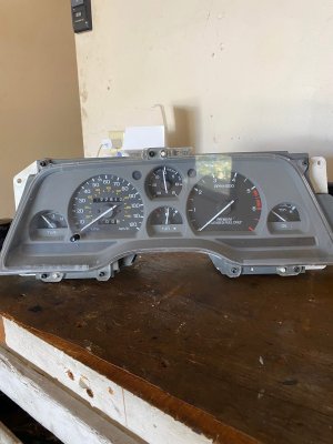

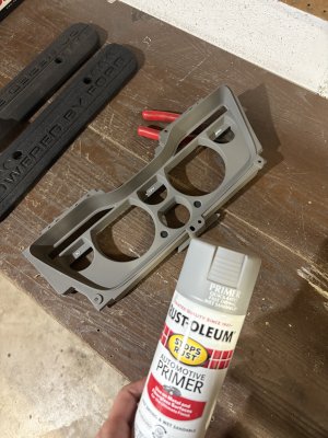

I found an SC gauge cluster on FB for sale, I’m thinking of buying it and swapping the boost gauge over to my cluster. That should swap no problem, right?
I’d like to eliminate a gauge in the A pillar pod.
I would just swap the boost gauge, not the whole cluster, I also think the boost is one with the fuel.I don’t love the 89-90 grey bezel but yeah it’ll drop right in. You won’t really notice it but the 89-93 bezels are shallower at the bottom than the 94-96 ones too, though they physically interchange
Ah, I didn’t catch that. But I see it now.It is part of the fuel gauge but the opening of the bezel for the vac/boost gauge is substantially larger than the LX one for the volt gauge.
