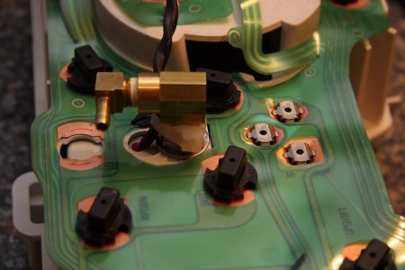

It is part of the fuel gauge but the opening of the bezel for the vac/boost gauge is substantially larger than the LX one for the volt gauge.
I know I'm late to the conversation, but was going to add that comment. It was a little unnerving cutting my stock boost gauge / fuel gauge in 1/2 when I installed the aftermarket gauge in my dash. I had to open up the hole in back to make room for the compression fitting required to connect the stock line to the aftermarket gauge, and I was able to stay clear of the copper traces of the factory wiring sheet?.garage_vehicle-26-12749379294.jpg

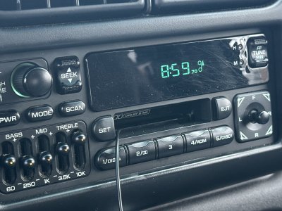

I was mostly interested in getting the ability to interface my USB stick with songs and a 3.5mm TRS jack into the car, less concern was sound quality. I never bothered upgrading the speakers or amp; too much monkey business with the component setup in the Marks. :)

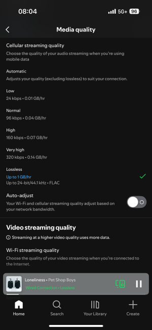

Does it matter that Spotify audio quality is lossless when it's connected to the stereo with a cassette adapter so cheap it triggers the CrO2 pickup?
I don't know the frequency response of a cassette deck (probably something like 40-13,000), but I doubt it goes as high so that the improvements between lossless and 320k are apparent. IME 128 to 320 is noticeable because of artifacts regardless of frequency, but above 320 less so. This is assuming a more modern codec, anyway - MP3 doesn't really sound much better at 320 than it does at 160; it tends to fill the extra bitrate with garbage at higher bitrates. More modern codecs are more efficient and both sound better at a given bitrate compared to MP3, and actually use the higher bitrate ceiling to improve sonic quality.
If you're paying extra for lossless, yes, you're wasting cash.
I can tell between mp3 @320 vs flac vs cd. and my hearing sux,lol.
Brandon, good casette decks can go 20-20k with chrome or metal tape. The one you made me the tesr tape for can. Those casette adapters, not so much. They're fm quality,50-15k roughly.
I was halfway being sarcastic with my question, but I do appreciate that you know this. Because most don't.
The only time I notice a difference is when I have it connected to the Edge's B&O system via USB / CarPlay.
I am not thankfully. It comes as part of my family plan.
