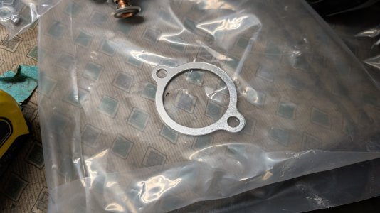

On the Dorman intake, what is this gasket for? I imagine it's important...?
Like,.I know where it goes and how it sits, but is it important? And if so, how important is it?
Looks like it's for the thermostat housing. On the OEM intakes it's just a rubber O-ring that sits on the top of the thermostat after you put it into the intake, before you bolt the outlet adapter on. I assume on the Dormans they want to you omit the OEM rubber gasket and use that instead.
It looks like the shape of the thermostat, however at least on our cars, that seals with an O-ring. Maybe on some other applications, they use a gasket, but if the O-ring seals, use that instead of the gasket.
It almost looks more like a graphite exhaust gasket, but it's definitely thermostat housing shaped. Could it be a spacer?
I thought it was graphite immediately, but unsure why
Maybe it is a thermostat spacer 🤔.
The kit also came with an O-Ring for the thermostat as well. If it is a spacer, what or why are reasons for me to want to use it?
Yeah... unless the new Dorman casting is sufficiently different compared to the OEM intakes (which I can't vouch for), I can't think of a reason to use it especially if they include the O-ring.

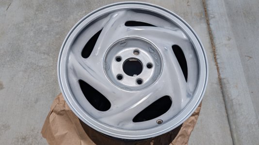

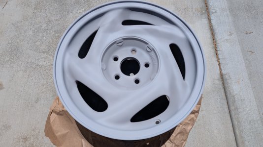

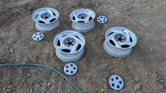

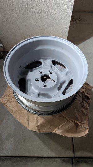

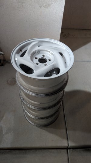

Ready for paint! Literally just finished the last wheel.
This project has definitely taken me much longer than I'd have liked simply because everyone and their mother here in my region seems to want my attention for one reason or another 😑.
I've taken them down to what appears to be the factory primer because some spots (as seen here) are down to the bare metal. My process up until now has involved applying HVAC cleaning solution, brushing in said solution, washing off said solution, then followed by 220 grit sanding, followed by 400 grit sandpaper.
All I know is that this would have been so much easier if I had taken them to get powder coated. But I'm being cheap and I can only pick two...

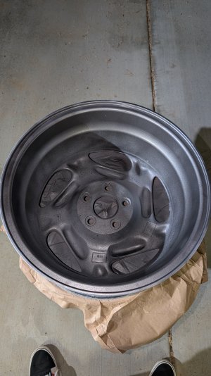

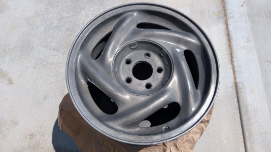

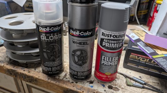

Currently painting my wheels for my Gold Bird. First coat of Duplicolor Graphite Metallic down. Can't say I like the spray nozzle of the Duplicolor cans compared to the Rust-Oleum nozzle. I'll put more pictures up on my thread when this is more complete.

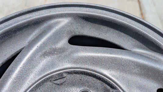

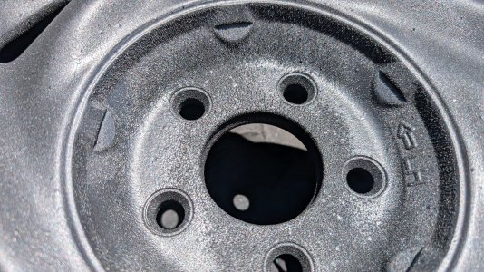

Just got the second coat done and I can tell something is definitely going wrong with the application. The color itself is great for sure, but the application is.... off.
What are these "fuzzy" things and how do they get corrected? It's most predominantly in the center cap area, but there are some spots on the wheel face with them also showing.
Thanks for the advice!

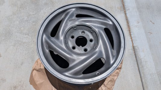

I brushed off the fuzzies and applied another coat. The fuzzies did get corrected some and I can live with it, so now I know what to do moving forward. 90°, 29% humidity , and UV index of 9 for weather sure does make this dry real quick then!

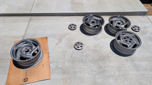

Both clear coats on. I used up about 3/4 of one can for color and about 1/2 can for clear. It's definitely hot out right now and that 3rd coat of color definitely went on better, so like you said @MadMikeyL , it was just drying out before it even got on the wheel. I'll try again tonight for the next wheel and it being cooler should help with the application process better.
But for my first time painting wheels, I'm pretty happy! 🙂

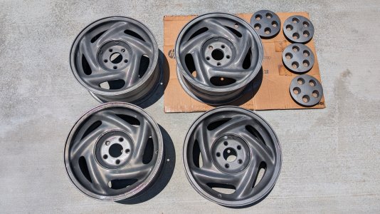

Just about done getting these wheels painted. Just need to wait for the current cost of clear to dry before applying the final coat of clear.
For having gotten them DIY painted, they came out alright. I'm not professional painter by any means and at close distance, you can tell. But, at 10ft, they look fantastic.
At some point in time, I think I will get these wheels powder coated, but right now is not that time.

I like the color. The finish is a bit blotchy in some spots, but as long as it looks good in person, that's what matters.
Did you position them vertically to paint?
Generally speaking, it's easiest to achieve an even spray from a can when you hold it vertically; therefore, you position the part to be painted vertically, as well.
I did not position them vertically. Live and learn, I guess.

If you're absolutely not happy with the result, grab a bottle of acetone and just wipe the paint off the front fascia of one of the wheels. Position the rim vertically, e.g., on a block of wood; you may have tie it up from the back through the lug holes to keep it from tipping over. Then hold the can vertically and paint in uniform, thin coats to prevent any dripping; wait between coats. Don't apply clearcoat until you're satisfied with the color coat.
Always start spraying before sweeping across the wheel, and release the spray nozzle  after sweeping across the wheel. Never push down/release the nozzle while facing the wheel.
