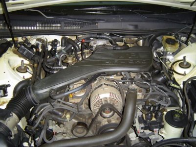

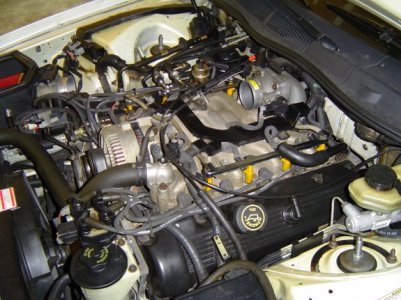

Thinking about getting this 97

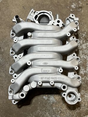

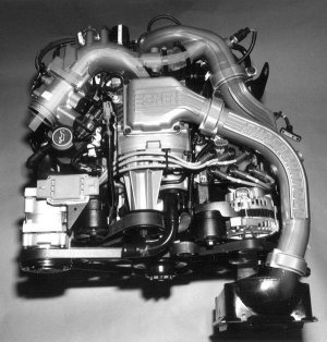

They also made this version. Its more better. Also made from alu-minium 😉.
Too much plumbing.

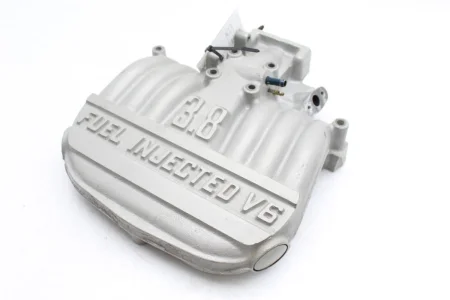

I'd go to a jy, and get a real pi intake. Get the valley tube and alternator bracket too. Way better manifold.

Was the boat anchor recast from a 5.4? :rofl:
Wasn’t it Leland who accomplished his 5.4 swap using this manifold with one side of the runners widened? 😆
That was j.miller. freddy welded the intake. Leland used propane heads, and needed a blower to run; it had the 'wart' in the hood to clear.

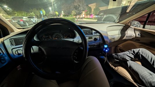

Now, as I write this sitting on the driver seat waiting for my wife and daughter to finish their shopping run, I plugged in my old 12v BT adapter into the cigarette lighter to broadcast via antenna to my speakers. It's archaic compared to today's technology of touchscreens and whatnot, but it's the only way to get any sort of "tech" into this car short of finding a single din solution with touchscreen at a reasonable price.
Writing this as I sit with my boy - him riding shotgun - and admire the view and admire the car as we wait for my wife and daughter to finish their shopping run.
