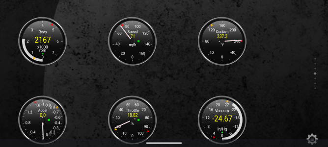

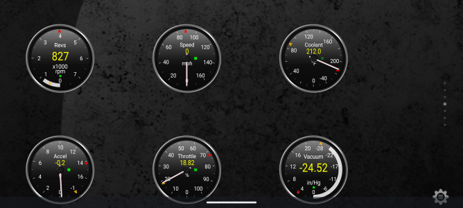

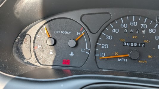

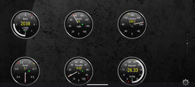

Maybe the coolant temp sensor is acting up? That seems way hotter than a 4.6 in these cars should get. Been driving mine around with the stock radiator, and when warmed up it's always in the same spot on the gauge regardless of how hot it is outside. I replaced the temp sensor in mine when I did the PI intake and newer style water pump. But even with the original parts it was cooling just the same. Do you have an IR thermometer to check the underhood temps?

It's not that I'm worried, it's more that I'm monitoring and announcing (posting) about my monitoring of my engine temps.

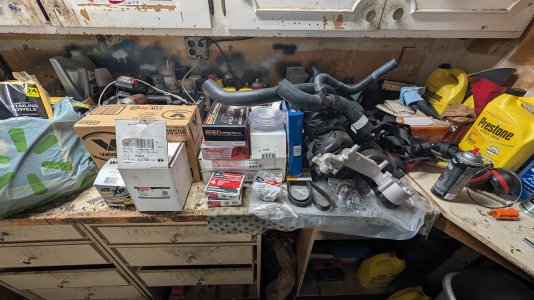

I haven't done anything to the car except swap my sport wheels and get new tires. All the maintenance items revolving around cooling and intake manifold will be done tomorrow.
For all I know the coolant in there is original to the car. Getting new coolant in there alone ought to make a world of difference. But with a new thermostat and closed vane water pump, I'd imagine it would also be a big help as well.

		I'm doing all that tomorrow. All parts are in now. Fresh coolant will be in. For all I know, the existing coolant is original to the car.Plumb in a mister, homie. Even that shit analog gauge is making me nervous.

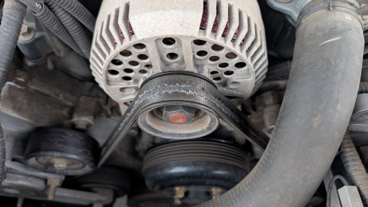

		Consider replacing any/all vacuum lines. Just like that upper radiator hose, im sure they are too old for Trump/Epstein and probably too old for DiCaprio as well.Serpentine belt seems to indeed be original to the car. I can't imagine what other rubber bits are.

		As a mass air system (not speed-density), our CDAN4 PCMs don't have a functioning PID for manifold vacuum.
Some programs may extrapolate this value based on TP, RPM and load data.
		On my 4.6 cars, Idle vacuum is ~ 18" mercury, iirc.
