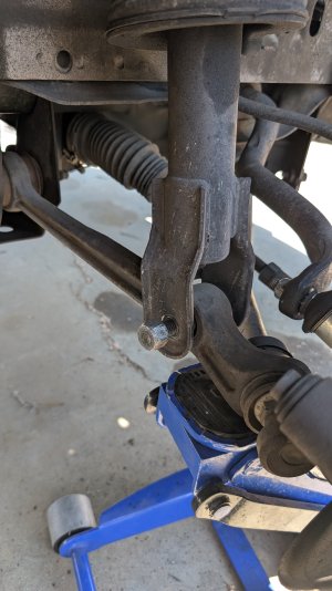

You can replace just the ball joints in the lower arms in you so desired.
If the lca's are toast, do them All. uca,lca,endlinks, strut rod bushings, tie rod ends.
Order the energy suspension sway bar bushings, diff mounts,and look at the rear endlinks.
I do this every 120kmi or so.
I've got a set of refurbished front LCAs, of you need good ones. I can't remember if they are Ford or aftermarket, but they are good. They came from Ian's Cougar(BMW Ian,)

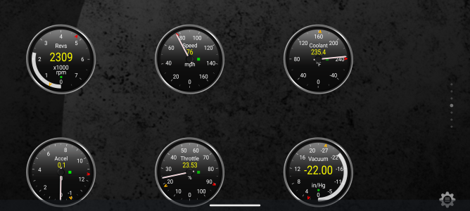

FWIW, I notice that my temps go down when I'm cruising at slower speeds. What's up with that? Like, how could less airflow make the engine run cooler? Is because of less strain on the engine (RPMs)?
Still no transmission temperature reading? Because that's been an unknown so far, and transmission temperature goes up with cruising speed based on my observations.

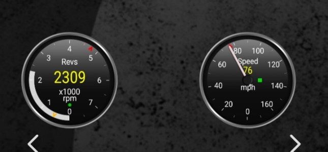

Aren't your revs a bit high? I wonder if your torque converter is slipping. Can anyone else chime in? I don't usually cruise at that speed, but from memory the revs look about 100 rpm too high (?).

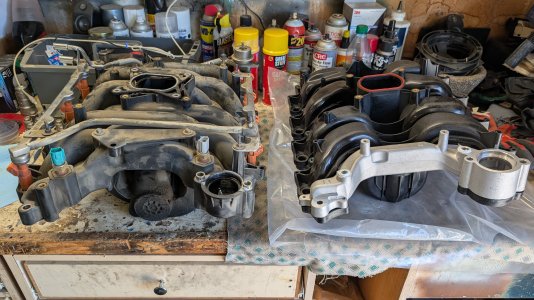

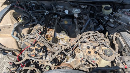

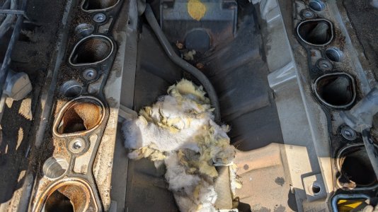

Those lil' schitz...The rodent nest was decently sized, but now it's all picked up.
It's not a lot, but it's still a lot, lol. The most tedious part has been the IM.
I may be totally off target here, but based on my calculations, at 76 mph, your revs should be 2,196 rpm, assuming a 3.27 final drive ratio and 0.7 top gear, as well as 225-60-16 tires.
Based on the same calculations, at 60 mph, your revs should be 1,734 rpm.
Your revs are at 2,309 at 76 mph. I think there's something going on there. That would also explain some less than expected fuel economy. Do you remember when that screen shot was taken? Uphill/downhill? Cruise control on/off?
Again, I may be totally wrong. Wait for others to chime in in the morning.
