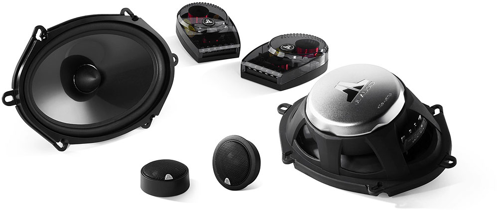

6x8" is the factory size. 5x7" was (and still is?) the predominant aftermarket middle oval speaker size, but they have the same mounting points. However, the frame of a 5x7" is physically smaller and will leave a small air gap around the car's speaker cutout. I created a mounting ring for the JL Audio 5x7" below that I ditched when I put in the Alpine 6x8".
6.5" round speakers are everywhere if you want other options. In terms of surface area though, the cones are smaller than 6x8", so I never really entertained making that swap in this car. 6x9" has been discussed a bunch in the past as well, but I find those unnecessary and inappropriate if you run a sub.
