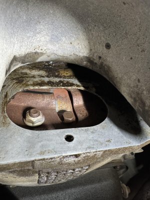

IIRC easiest way to get the torque convertor drain is remove the rubber cap, then use a flat blade screwdriver to push on the flex plate gears and rotate it. That is how I have done it in the past. Saves time crawling in and out from under the car to try and get the drain lined up.
Ok so in the interest of being safe and not unbolting the wrong thing, this is the Torque converter drain bolt right? the little one not the silver nut with the flange. Its a dumb question i know but I do NOT want to start taking a bolt out before I know exactly what its for.

Well, isn't that interesting! Totally different from the 4r70w. I'm guessing that's what it is, but wait for one of the other guys to confirm.
On 4r70w, the drain plug points straight down.

Yeah, I don't have an aod. My suggestion would be, pull it and if a few quarts of mercon comes out, that's it. :)
The other one looks like the flexplate bolt I always strip, because it's standard ,lol.
