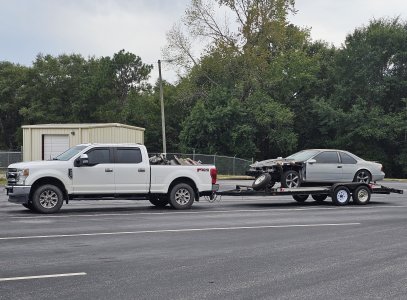

I turned her into a covered trailer. Making the move from AL to GA. The car is packed to the ceiling, including the trunk. With no engine in the bay, it looks like it's pulling a wheelie.
Safe travels. Can't wait to see it put back together.

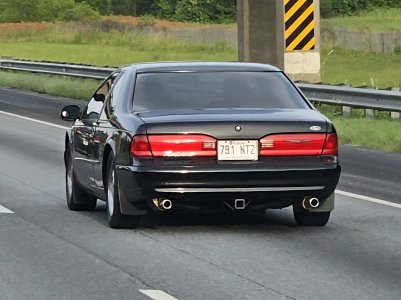

While going up I-85 yesterday between Montgomery and Auburn, I came across this guy. What a coincidence as I never see MN12s anymore - certainly not nice ones - and the one day mine has seen the sun in like 3-4 years. I can't make out the state on the tag. It was a very clean, lowered 94-95 with what looked like 97 tails and chrome fanblades. He got pretty excited when I passed him with mine on the trailer, but he didn't follow me into the fuel stop unfortunately. Maybe he's on here?
Quebec plates. Period-correct 6-digit design from 94-95, so he's likely the original owner.
Which makes it even more impressive as the most common colour of car in Quebec is "rust".

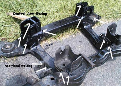

Was looking through old FB posts and found this post by dale brown?? Anyways he mentions he made a cradle to “box” the IRS subframe. It ties between the pinion brace and the lower control arm brace basically making a square. What do you guys think??
also also,
I came across this article on the TCCOA website. It details some additional welding to the IRS subframe. Have any of you guys done it? Does it make a difference?? I have seen the stock welds when I put solid bushings on mine and they stock welds look atrocious, not even fully welded. Kinda like they almost just tacked it together.
That exhaust hanging that low looks atrocious, and I don't see the point. If you have a beefy diff cover brace and the LPW or Freaks cove, plus the pinion brace, it isn't going anywhere unless you're at insane power levels.
I did think about having mine welded, but not sure if it's worth it. The pinion and rear cradle brace get rid of the vast majority of deflection.

@Zep5.0 I feel like he made it so it doesn’t flex, the front portion to the rear portion. No im the sense of the diff moving. Those welds on the IRS are piss poor tho, I can’t believe they left the factory that way. Every other one from different manufacturers have welding ALL the way through. Kinda wack they skimped out.
@XR7-4.6 the brace or the welding??
The brace would be working on motion from front to back. With the diff mounted with a good cover, mount, and pinion brace, I just can't see the load causing any movement. You also have to remember the LCAs are holding it front to back. Having just put one together, I guarantee that's just added weight.
The welds are sorry, at best. I did take an angle grinder and smoothed them out a touch before painting mine. Just for aesthetics, tho.

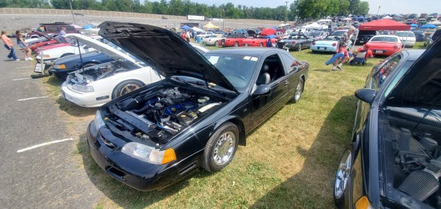

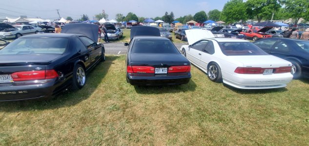

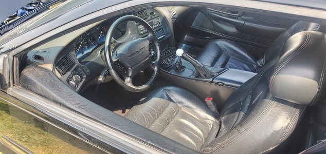

That Quebec tbird a nice one. It's a mark bird. Mark viii motor, interior and wheels. They're regulars at Carlisle, very nice people too...
Oh that's awesome, good catching that. jco takes a pic of a bird and gets 3 pictures of it back! Gorgeous car too.
