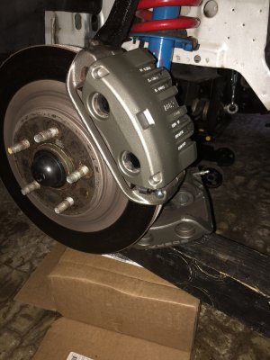

Got the new (reman) caliper on. Very frustrating I couldn’t find one with the Cobra lettering so the right side of my car is going to be just a little cooler than the left side lol

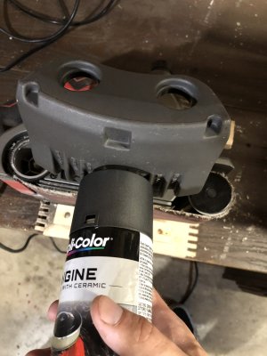

Luckily I found a can of the cast iron engine paint I used on all of the other calipers so that’s a match. This stuff is an almost dead ringer for the factory grey finish(which this reman remarkably still had but with lots of scratches)

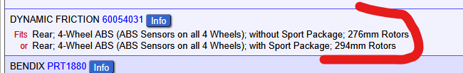

So if those physically existed then shouldn’t there be sport specific rear calipers then? Just sayin.
I think you may be seeing this description and it is slightly confusing, but the diameters mentioned pertains to the front disc rotors, not the rears. The rear sport discs, as stated, are exactly the same as the non-sport discs.

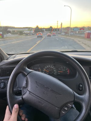

Dropped some new lower controll arms in the t-bird today! Good news: it no longer pulls to the right when braking. Bad news: it’s desperately begging for an alignment. We forgot to mark the camber bolts when taking off the first control arm, so now I’ve got like 5 extra degrees of camber on the passenger side front tire. My wheel also looks like this while going straight now so that’s a plus.
Took us about 3 hrs to do the whole job, ended up needing a torch for the passenger side bolts on the shocks, cut em in half to get it off, drivers side was nice to us and was done fairly quick.
Bringing it into the shop next Wednesday with my buddy to do an alignment on both our cars, il probably upload what the results ends up being.
Very glad with how it came out, no longer pulls to the right and drives a lot smoother and more rigid to the road
