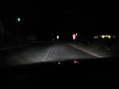

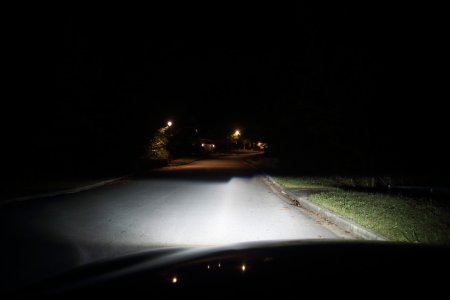

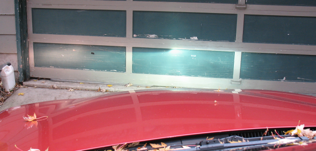

Factory halogen on the left, projector HID (at the time it was 6000k, I went to 4300k not long after and it was both brighter and a more visible spectrum) on the right.

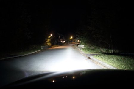

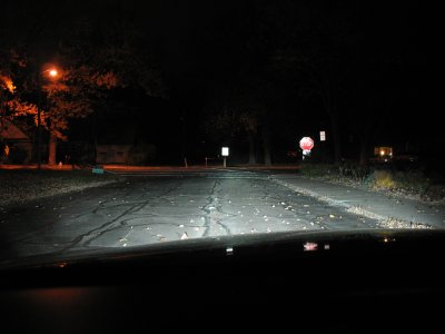

Remember my picture when I added in fog lights? All 4 turned on:
Here's the same view with the HIDs. Same exposure according to EXIF data.
Here's the same view with the HIDs. Same exposure.
These are the kind of results I'm looking for!
What, besides putting in the HIDs, did you do?
Projectors.

The projectors are key to Brandon’s setup, any other approach with simply using brighter light sources in the stock housings will scatter excess light rather than focus it where it actually benefits you

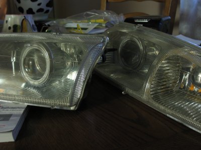

I have a spare set of headlight housings that is had intended for Dirty Bird which I'm willing to experiment with before going over to my clean Gold Bird housings.
That said, would these (or similar) projectors work for retrofitting?
