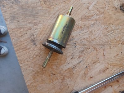

In the name of science, I cut open the fuel filter I replaced the other day. This one has a bit over 40,000 miles on it.
And what you see is...that you don't see much. After drying it for a few minutes in the sun, the tank side is distinctly darker than the engine side, but that's about it. If you see any metal bits, that's just from cutting.

I cut mine open after 105,000 miles and there was a lot more shmoo on my filter, the fuel I also dumped out of it was black

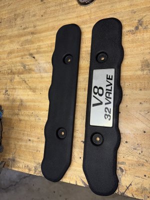

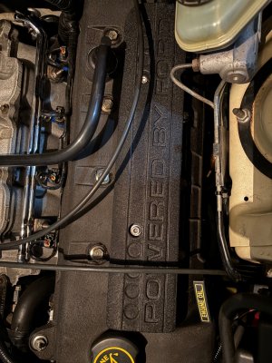

You all remember early this month I refinished the left Ford GT coil cover that got brake fluid on it? Well I didn’t like the result compared to what it used to be, the wrinkles were kind of inconsistent and retained a very dark glossy look that doesn’t match the main valve cover well….
I’m kind of over the GT coil covers anyway (at least in this finish, subtle coolness aside they’re kind of wasted just black) so today I decided to use up the can of wrinkle paint on a regular set of coil covers with a better technique, which I now suspect I did on the valve covers originally back then, and the result is pretty excellent
My recommendation, DO NOT follow the instructions on the can directly. The horizontal - vertical - diagonal pattern for each coat does work better than one direction only but do it backwards, it is way more likely to tiger stripe ending on a diagonal IME.
The can says thick coats… don’t do thick coats. Light for the first and light to moderate for the next two results in much tighter wrinkles and a more matte finish in the end. I also suggest waiting 10 minutes rather than 5 minutes between
Heat up the can. I have found this to really help avoid spatter from rattlecans and I tend to get better coats from it in general, but with this thick wrinkle paint it helps a ton for keeping the nozzle flowing. All you do is fill up a bucket with hot tap water and submerge the can in it with a weight on top for about 20 minutes.
After your last coat wait 30 minutes and hit it with a heat gun. Just go around it fairly evenly and just focus on getting the metal warm rather than worry about what the paint’s doing(don’t just point it at a stubborn spot that’s not wrinkling). Once it’s mostly wrinkled just stop and wait and the heat still in the metal will usually pop the areas that weren’t wrinkling eventually.
If there are areas that don’t wrinkle after this, don’t follow the cans instructions about touching up just the stubborn spot, it looks like crap trust me, instead just hit it with another full coat on the piece. The paint melts back into itself and it’ll rewrinkle evenly as long as you’re doing this within an hour or two of the last coat

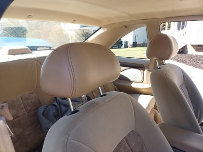

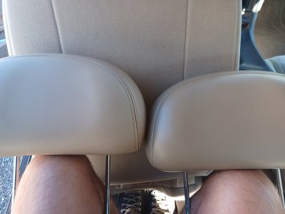

Replaced my headrests with true Light Prairie Tan units from the Mark VIII (my previous headrests being grey units painted with beige Dupli-Color Vinyl and Fabric).
The difference is subtle in pictures, but noticeable enough in person to justify the effort. The painted units (right knee) were slightly too dark and greenish while stock (left knee) is lighter and more reddish.

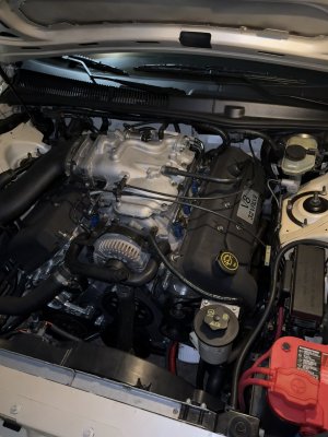

Coil covers seem sufficiently cured so I threw them in.
So between these $20 junkyard ones and the $500 GT ones the switch to me is pretty much….neutral
Anyone want to buy these old ones? 😁

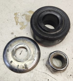

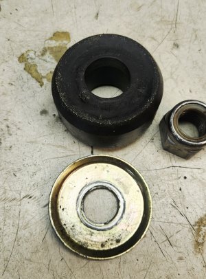

I heard a noise on the drivers side...
Not sure how this happened nor do I understand how the bushing stayed wedged up there. The last guy that did the alignment a couple years ago was a total douche.

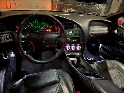

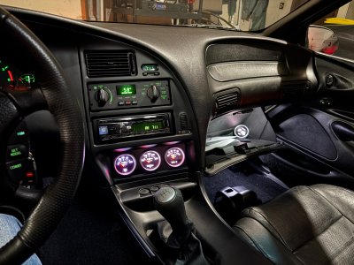

I have ditched the column gauge pod I grew to absolutely hate…. Which was quite a bit more work than it sounds. The tape holding it on ripped off some of the vinyl paint on the original shroud underneath and required me to strip and repaint it. I kept the toggle switch in the pods key release location I originally used to shut off the wideband but instead rewired it to toggle the fog lights(which I previously wired to always on after the console swap) in one position as well as the DRLs in the other.
What of the wideband you ask? It’s over here now 😆

Does your HVAC unit always show outside temp, or did you push the button before the pics?
